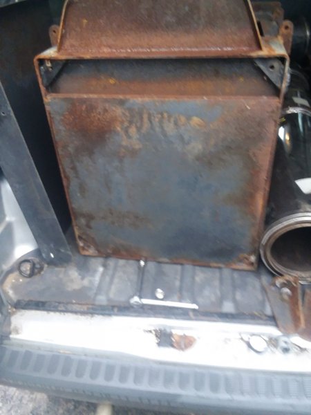

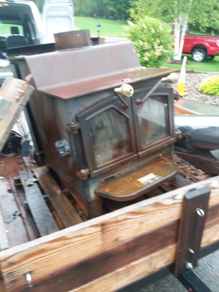

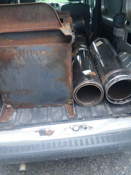

    Thank you so much for the pics. I will get this unloaded in the morning and get some pics posted

    Removed the legs so i didnt break them . its a good thing. i slid it back then went to move the van and it fell out. had to put it on a skid with my handy 8n

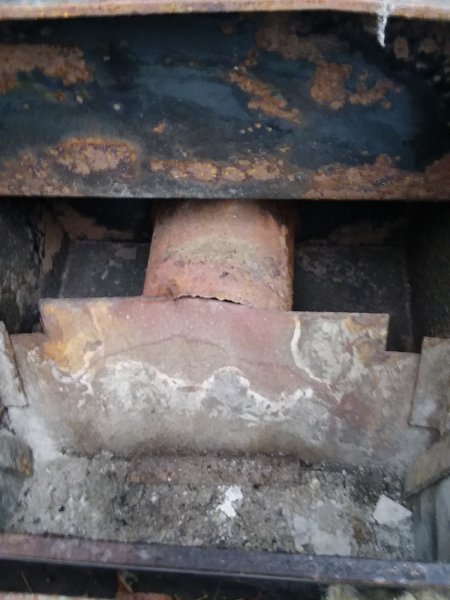

    Here is a picture of the baffle plate.

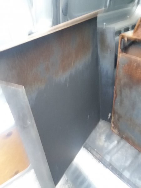

    The back heat shield

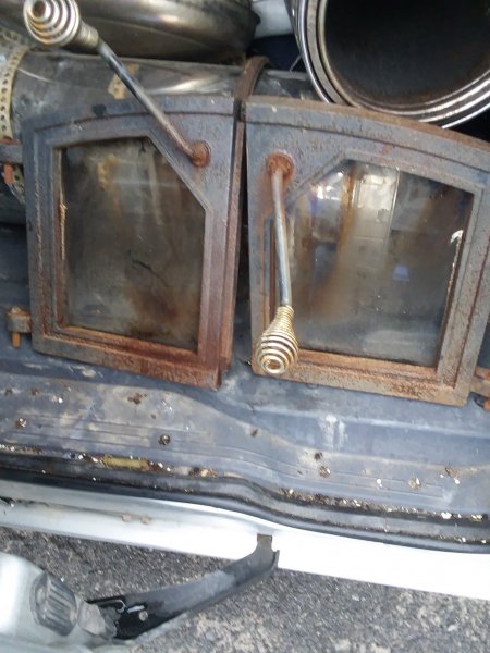

    The doors

    The picture of the baffle and the way the pipe rests on it , is it accurate ? I noticed the baffle is curved upward in the center. Looks to me it was bent that way . Maybe someone can clarify .
    brenndatomu and WeldrDave like this.
  13. WeldrDave
    10,207
    56,308
    No! That pipe inside is not original. The baffle is warped. Your baffle should be 5/16" or larger, I like 1/2"+ You should only have maybe two or three inches of pipe inside the stove. Go back and look at my pics.

    Thank you Dave for clarifying that . I thought it didnt look right , but never seeing one made me wonder.
