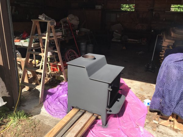

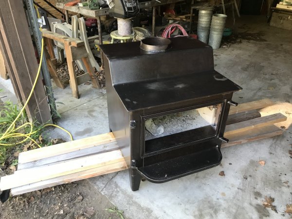

    This stove has been sitting in my garage for a couple years now. I got it for free from my dad, who also paid basically $0. He was looking for some double and triple wall pipe to hook up a VC Defiant for his new pole barn. He found the pipe he needed on CL but it came with this stove. Lucky for me because pretty soon I’m going to have a new pole barn I want to heat too.
    The place he got it from was in the business of cutting stone countertops with water jet CNC’s. It was in pretty rough shape.
    I hired my buddy Adam to help me with the metal working parts, but neither one of us is really a stove expert by any means so I wanted to seek out some advice. He started work on cleaning the rust off of it yesterday.

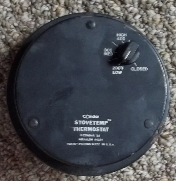

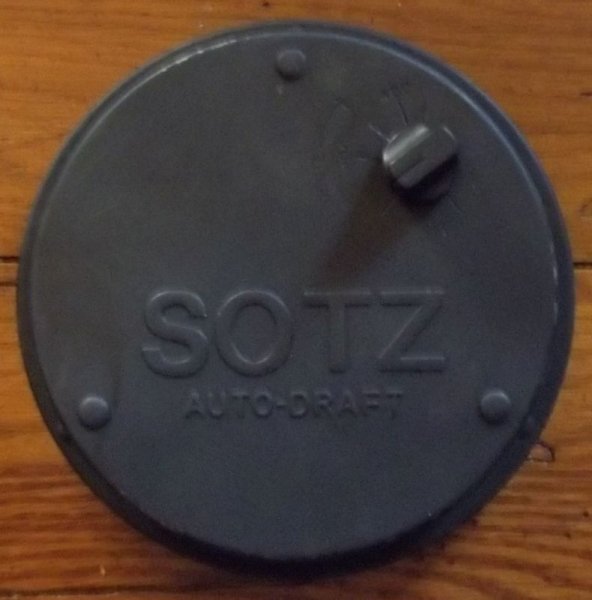

    The air intake is called an air damper and the left side was replaced with a bi-metal thermostat that was made by a few companies. They work very well. Looks like a Sotz Auto-draft, the same company that made the Monster Maul, or Condar that makes the magnetic pipe thermometers. Need close up pics of it to tell for sure.
    Intake dampers are available from Barr Castings in Oregon. They have the original patterns patented as EZ Spin. They were available in a few styles of aluminum or solid brass. They are cheaper cast new from Barr than eBay, and they now have an online store. I suggest using the thermostat if the spring is intact.
    Your stove is a Grandma III and should have a Smoke Shelf Baffle on angle iron supports inside.
    Here are pics of what it may be showing temp adjustment if your paint is worn off a Condar. Both are very good.

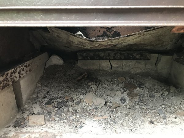

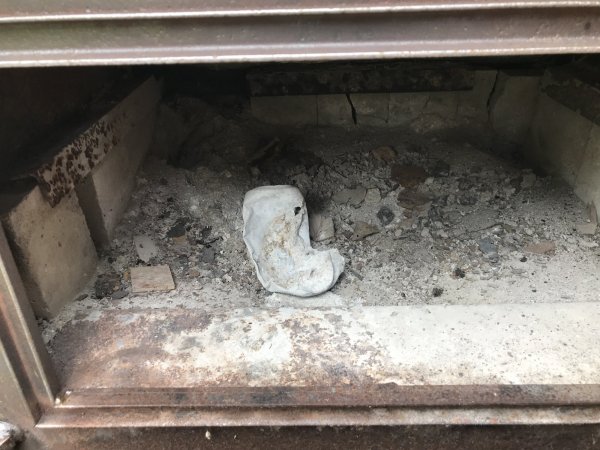

    Thanks for all the info Coaly ! I’m thinking the air control may be that first one, as there was no embossed logo on it. I grew up running VC Defiants, which also use a bi-metal thermostat; so I could see the advantage of having one. But given the condition of everything else I’d be shocked if it still worked.

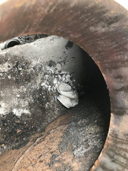

    It does have a baffle, but it looks like it melted a bit :bug: at some point. Guessing it must have happened when the previous owner was cleaning the chimney... :picard:
    534DA48A-B6B3-48AB-BDF2-50681509EBE2.jpeg 0FA65C58-690C-4121-8909-131440C745C1.jpeg F2E65FC5-04A3-47B5-9B3B-598BE0C7DA3D.jpeg
    Adam thinks we could probably get it somewhat back to shape using a block of wood and a bottle jack.
    Barcroftb, WeldrDave, Eric VW and 3 others like this.

    It looks like there may have been some cold beverages involved in the chimney cleaning process:picard:

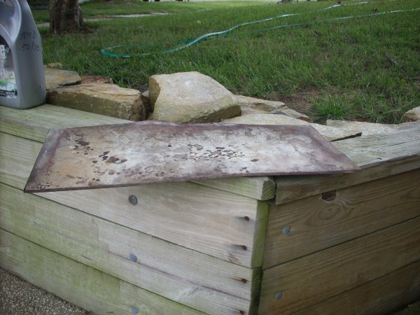

    Wow, that takes some abuse for a melt down like that. That baffle should be 5/16 plate which is the same material as the top. The rest of the stove is 1/4".
    Here's the same baffle in my Goldilocks (same width stove with a pedestal base approved for mobile home use) that was my only heat source for many years and my first Fisher product brand new. Still flat and never cleaned inside! The 2 inch X 3 inch notches cut out on the ends are designed to prevent stagnation in the front upper corners. The baffle was added in 1980 to reduce smoke particulate and actually reduced particulate from 60 grams of particles down to 6 for every kg of wood burned. It still wasn't enough for the stricter epa regs that went into effect in stages and they ceased production in 1988.

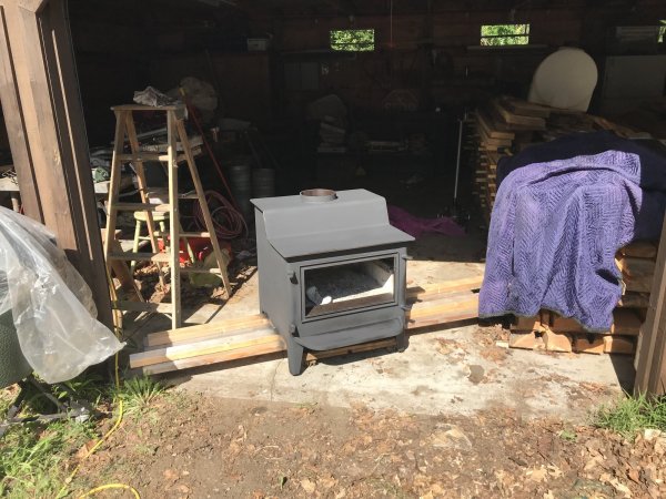

    Shawn, Coaly has got you covered on things, the only added thing I can say is if you can get a 3/8" plate for the baffle, I like to go heavy. Although, 5/16 is fine, for the extra couple bucks if you buy it go heavier.
    She looks nice! :yes: Also, while she is down to parade rest, invest in some new fire brick. :)

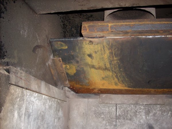

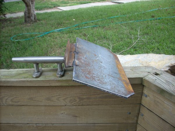

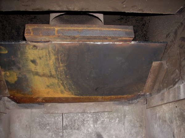

    Many pics of baffles, I'll dig up some of mine, Coaly has some as well. When you replace your's, "My opinion", go thick! I like 1/2" or bigger. Yes it's heavy and a pain in the @$$ to put in but you'll only do it once, "maybe twice" like I have,:whistle: but it's a worth while investment for heat and "will not warp easy"... :yes: Here's a pic of an old one out of Grandma that I took out and one I replaced it with. I eventually had to cut the angle iron off because it was "Too much" restriction. I was trying a little experiment with heat dispersion/deflection. DSCN0745.JPG DSCN1364.JPG DSCN1366.JPG DSCN1371.JPG DSCN1372.JPG
