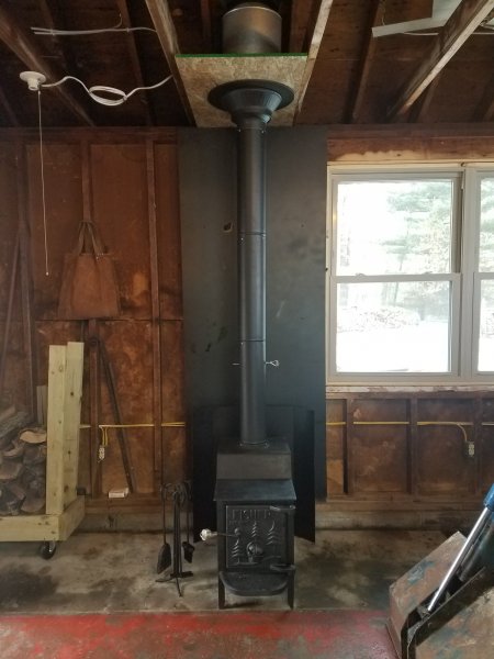

    You need a support box for the triple wall to sit in,then the single wall is joined to the triple wall underneath this.The support box needs to be at least 18"x 18" for 6" stovepipe it will be level on the bottom cut and bent over to match roof pitch on the top.

    I did some more reading and found the answer I was looking for. Luckily I do have all the necessary pieces, the instructions are just a bit vague.
    Hope to be curing the paint this evening.
    BTW, I am following all required clearances and code requirements. You may notice the light fixture in the ceiing that is too close to the stove pipe - on my list to relocate. It may not be the prettiest setup, but I want to make darn sure it is safe.

    Installed. Took twice as long as I thought but I am very happy with my final product.

    Looks good , you will like that baby bear. A flue thermometer would be nice that way you will always know where your at .

    I can’t remember what it’s called again but the piece with the ceiling trim ring around it will get screwed to the rafters and support the chimney. The single wall pipe from that adapter to the stove will have no weight resting on it. You will need to frame out a box to support the adapter.

    First and foremost, thanks again Dave for talking me out of a drum stove and into a Fisher.
    Install went very well. Chimney is 14' straight up and out. Sellkirk has an excellent product line. Very very happy with their products. The directions are vague and I had to do some internet searches to complete the install but otherwise I highly recommend their products.
    Two heat shields are being used behind the stove. One is 26g sheetmetal ran all the way up the wall spaced 1" with ceramic spacers onto plywood. The second is a 32x32 piece of 1/8 steel with 30 degree bends in each side. With stove at full temp, all surrounding areas are cool as can be.
    After 2 days of burning, I realize I have much to learn as with any new stove. I feel like I'm feeding the baby an awful lot of wood so I must be feeding too much air.
    My garage is 24x24 and is completely uninsulated. I have a feeling that I'm going to be wanting atleast the ceiling covered to really reap the benefits of this stove without over firing it. I know without doubt that when I someday have it all sealed up and insulated, it will be too hot!!! :D
