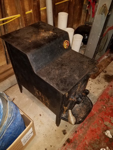

    Picked the little guy up tonight. Super excited! It's smaller than I thought which is perfect for what I was looking for. Needs a bit of TLC but looks to be in good condition from what I can see. Door is nice and tight, no rope, no baffle, handle is a bit loose inside the pivot point, and it seems to rock on the floor a bit.

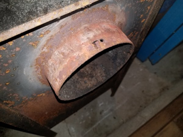

    Although I know I would loose a vital cook top and some of the heat, as I've read in other threads, I will likely need to modify to have the chimney exit the top rather than the back. I have a very reputable weld shop nearby my house that would do it for next to nothing.
    Question, If I was to have them cut off the old flue port, weld a plate over it, cut a hole in the top and weld on a new outlet, would I be significantly hurting anything? I have a welder and could probably do it myself, but I don't have any good means if cutting a new hole. Plus my welding skills are novice at best.
    Even came with an old Condor stovepipe thermometer.

    Sweet. I don’t think that it will hurt anything but I not an expert. If it were me I’d have them weld a baffle in when they cut the hole in the top. Should work great for your application. I had a baby bear for a hot minute once, I found it to be too small for what I wanted to use it for and traded it.

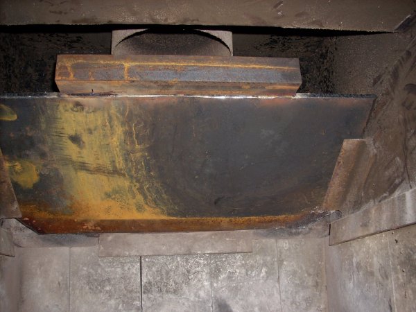

    I was figuring on having them atleast cut me the appropriate sized piece of plate steel so I could experiment with Coaly's baffle plate that sits on firebrick inside. I am sure it is the way to go but I'd like to experiment a bit. That's the fun part right?

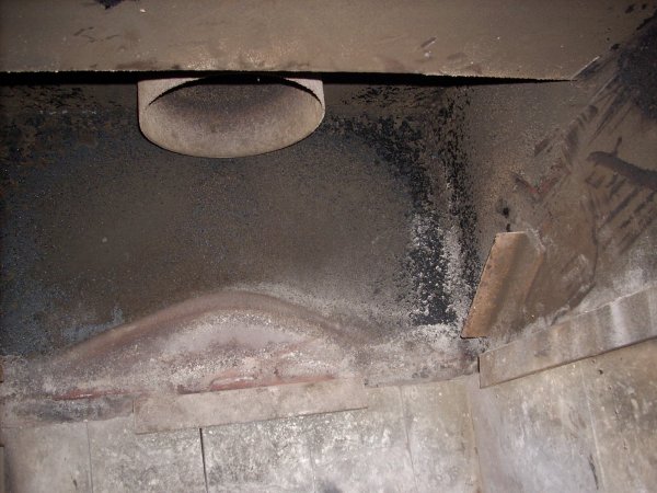

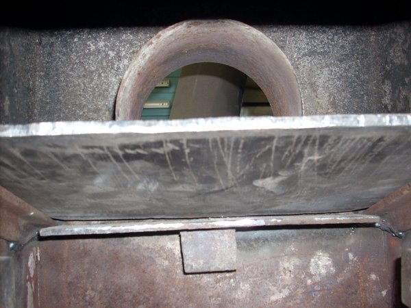

    Ok, you did it! :cool: Nice! Great price!!! First, don't worry about it being pretty because in a couple years it will start to rust and pit in the garage, "but" you now have a stove for the next 50+ years more out there! Second, unless your very limited on space "I would not" cut the rear flue out.
    Put a "T" on the back and have a bottom clean out for when you punch the pipe in the spring/summer. You will Thank me for doing that! Next, Get new fire brick!!! Spend $25.00 and it'll be a great investment for the stove and your heating area. Don't worry about the "Fisher wobble" They all do that over time with expansion and contraction, not to mention is the floor perfect? You asked about cutting the top and back out and replating, won't hurt a thing as long as you do it right and get 100% penetration. If it's not welded well, it will most likley crack. Seen it a few times! I'll put some pics up and you decide what you want to do, as far as a baffle, the "Top" flue stoves need a baffle for sure, you can get away without one in the rear flue stoves but it is recommend. I have a "T" at the top of Grandma where it goes into the wall, "best thing I ever did" and ease of cleaning also. Some folks put a 90º on the back but a "T" is better. I'm here if you need more help, I'm on less often now due to some family issues but I will check once or twice a day to see what you come up with. I'll check back tonight about 7pm. Dave:)

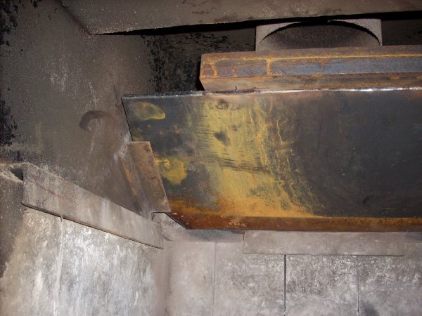

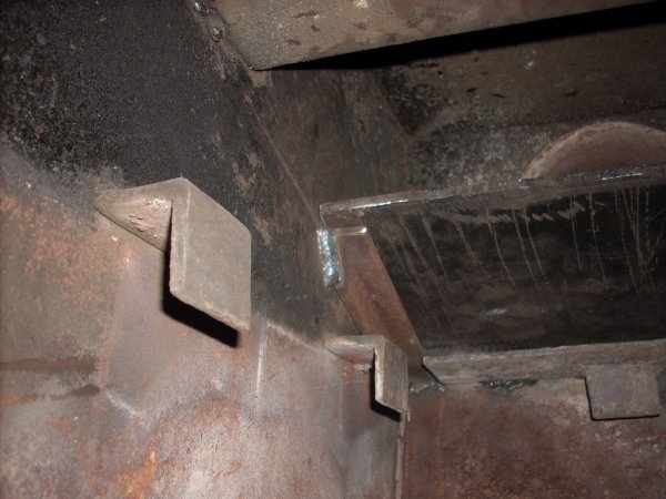

  15. WeldrDave
    9,278
    48,415

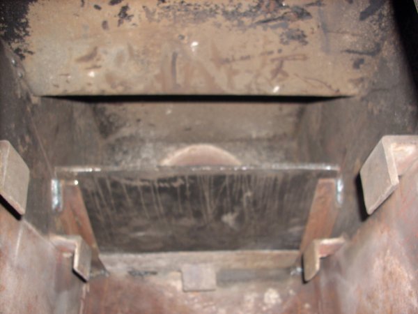

    Here's some pic's of a back baffle I put in one of my Mama Bear stoves. My Grandma is a top Flue and I installed a good size Baffle in her. I eventually had to cut off the angle iron piece I welded on the baffle, It was a bit "too much" restriction. You were worried about cook space, the baby is smaller but even if you close off the top you'll still be able to get a good size pot or pan on it! Also, You Fisher was "not meant" to have a door gasket, everyone who buys a used Fisher thinks that it needs one, Nope, It's designed that way. Next, Lift your door off, "don't drop it"... And spray the hinge pins and hole openings with "PAM", yes Pam... It's natural oil, lubricates, won't burn off easy and smell the house up and it'll stop that annoying squeek when you open the door! I understand why you want to go out the top, but if you can move it more off the wall I would keep the rear opening.
    shack likes this.

    I really do hate doing it, but I don't have any other option than having a top exit. I spent an hour or two last night moving the stove around the garage trying go find a spot that it would work with the rear exit and it just isn't going to work that way. I have a perfect spot for it but the top exit is a must. Oh well....
    I will be sure to stop by tractor supply and grab some firebrick. They definitely look line they could use replaced.
    Since I need the top exit, I will be sure to get the plate for the baffle and set it in bricks like Coaly shows.
    Any idea what ID the pipe that get welded in should be? On my Buck stove, the stove pipe slips into the stove so I assume it would be 6" ID?
