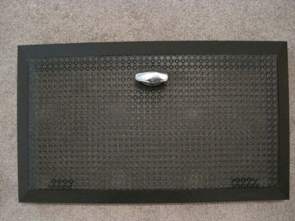

    Here is the smallest screen in the Contemporary style for the Honey Bear.
    Honey Bear Screen NEW Steve.jpg This is the smallest 2 door stove from the Fireplace Series.

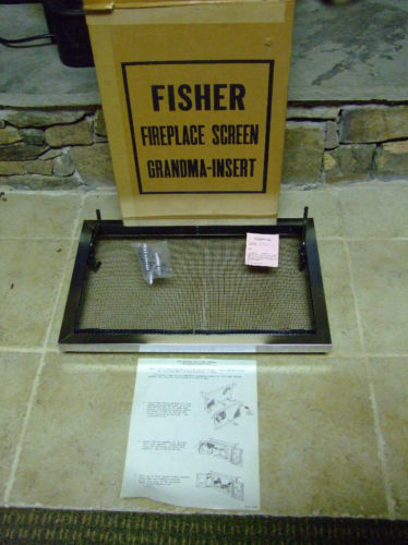

    Below is the most common;
    Screen eBay 12-6-11.jpg This middle size fits Insert, Grandma, Goldilocks, and Teddy Bear. This was the first with the "Cool Touch" handle.

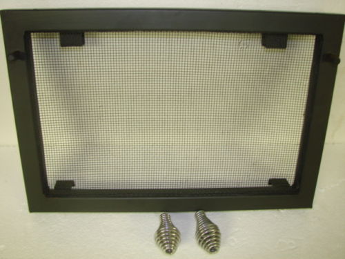

    Grandpa Screen front.jpg This was the first Grandpa Screen for 1976.
    Grandpa Screen.jpg This is the last screen produced for Series III starting in 1980.
    Grandpa shown, Part number 237-585 and Grandma #237-585-1. This screen can not be used with the older flat top doors since the ears go behind the hinges of the Cathedral arched top doors to hold in place. The Contemporary style with chrome frame can be used on either door type since it has locking latches on each side. The Contemporary style for Grandpa has been out of stock for quite some time and demands a premium when found, as well as XL stainless screens.
