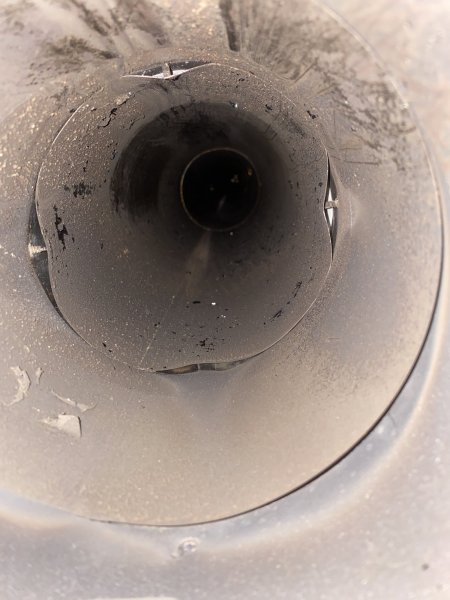

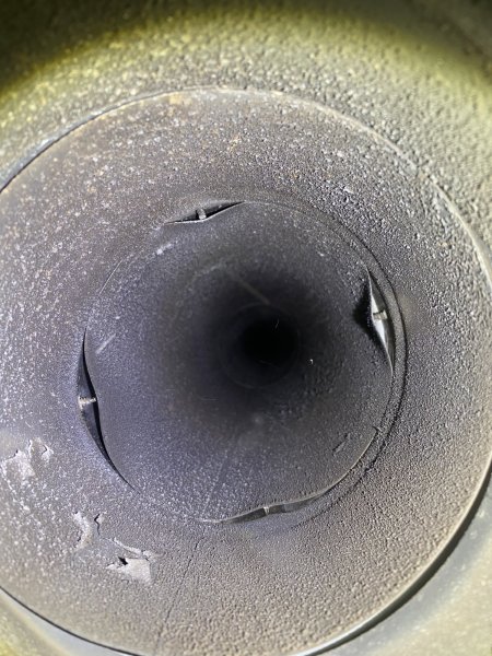

    Hey folks. Went out and bought a soot eater to give my chimney a clean. Using it for the first time, so I think I may have missed a few spots but from the before and after pics below you can see a fair difference in the texture of the inside of pipe.
    Before
    after

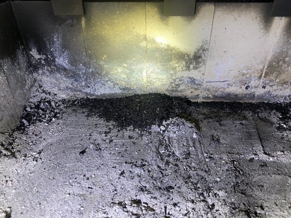

    What came down from the pipe was a lot of these little black flakes, which I assume is soot/creosote. Pics are attached below.
    Based on what you see here, is this expected? Or is this a sign that I haven’t been burning correctly or haven’t been burning dry enough wood?

    That isn't that much, and mostly dry flakes, so its not the worst thing, but something there could be improved a lil...just not sure what exactly.
    One thing I can say is you need to back those self tapping screws out and drill through that inner pipe...those areas where the pipe is pushed in means (cold) air leaks into the chimney, which doesn't help anything.

    If that's all of it, that's not much. Those look like curls formed when the film on the pipe gets a sudden blast of hot air . The film is there kinda like thin glass and while they are curling and releasing in flake sizes it sounds a bit like glass breaking. It would be cool to watch it happen. Some of your wood might be a tad higher moisture content than you'd like, you might be cutting the air back just a tad too much. I'd like to see what you brushed out be grey dust rather than those black curls but from the small amount you're probably doing just fine with what you've got to work with.
    The "before" pic looks kinda normal grey powder I see when looking down my chimney pipe(s). The after pic has a few black patches that must have been covered up with the grey dust and may indicate your burning practices have improved. Hard to tell from pics, but that's what it looks like.
    A bad habit/practice ( and I've done it) is trying to burn at a lower temp especially in shoulder season or overnight . I find I have to have one burn in the morning and just let the fire go out instead of trying to nurse it along during the day which tends to build up in the chimney from too low temps. Relighting the stove every afternoon on sunny days is a PITA but getting up on the roof to inspect/ clean out the chimney is more of a PITA. Now that I (try to) batch burn I really don't have to clean out the vertical part of my chimney at all.
