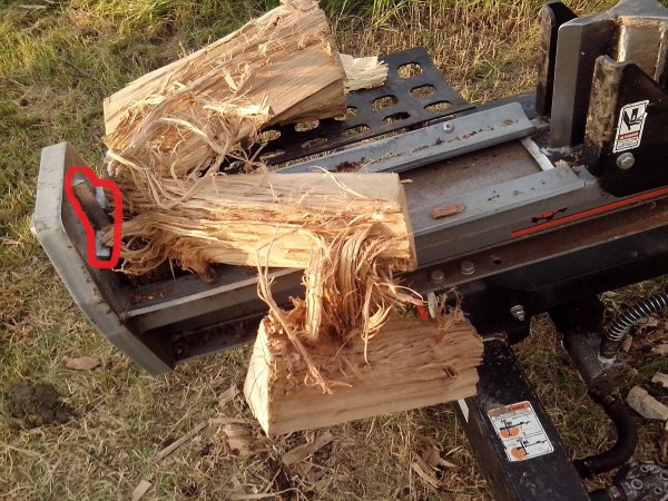

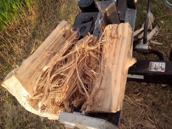

    Reason I mentioned push through is the possibility of a lot of this:
    Push through would slice right through. (pics borrowed from another forum)

    I've used push through and personally, I dislike them. I hate chasing the wood all the time...and push thru can't do vertical, in case you get some huge rounds that need busted up a lil before actually making splits.
    If you are splitting stringy stuff with a standard splitter, a wood block or another split stuck between the foot and "the problem" will finish it off.

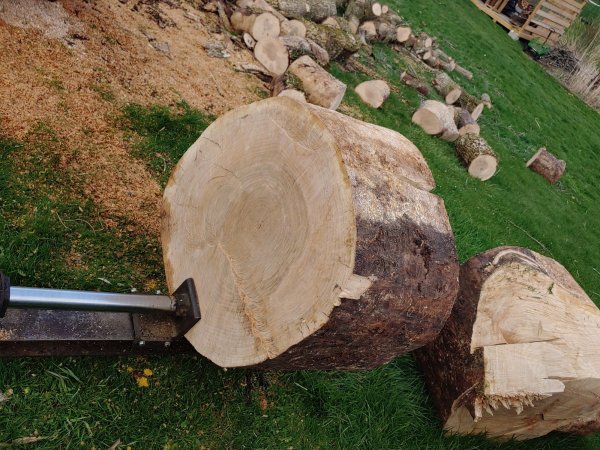

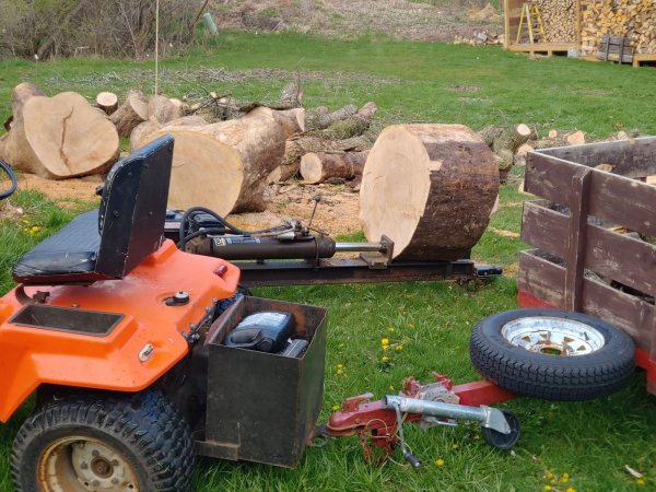

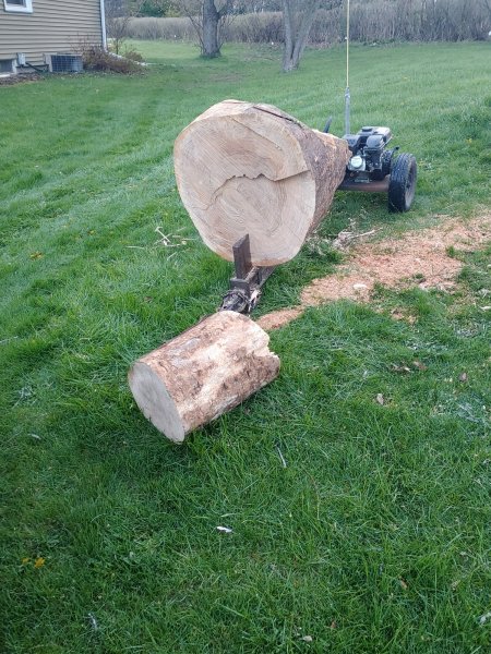

    Log lift for the win on many push plate style splitters.
    Or if it's low enough, just roll the rounds up, using a small ramp or splits. 20210421_193801.jpg 20210421_180714.jpg 20210421_180625_HDR.jpg
