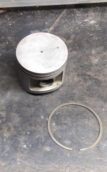

    The 375k cylinder is 51.4mm. It was put on the 372xpw for a period of time. So the piston will be the same.

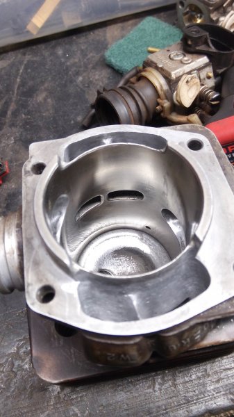

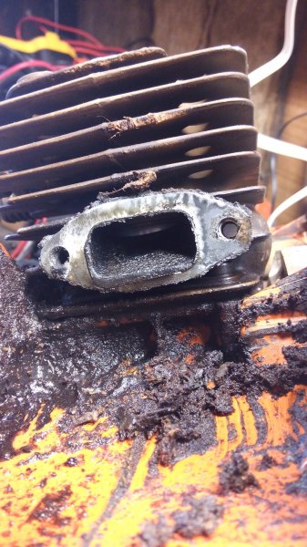

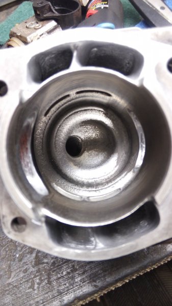

    Good mornin friends...well since I have to wait to get a piston fur the xpw, I have put that cylinder on hold. So I have started another cylinder...its just a plane 372xp cllylinder...I have hogged it...but I am havin a hard time gettin the costin off around the intake and exhaust ports...I have stones...wich be the best to get this off with...thank you... IMG_20160208_074913.JPG IMG_20160208_074856.JPG IMG_20160208_074836.JPG IMG_20160208_074804.JPG

    Have you run any of these?? I think I would run none first before you cut them all down. They may run worse based on your mods. Or it may not be any better than stock...or barely so that its not worth your time to mess with it. I would get some before cut times and then run your first one to see the gains you made.

    I use the carbide cutters to grind and then sanding rolls to finish.
    You want to square the intake up more and go lower on the corners or up in your pictures.

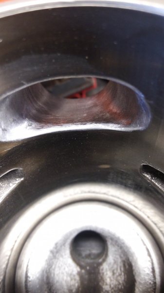

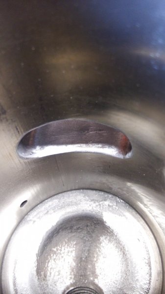

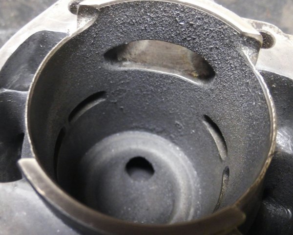

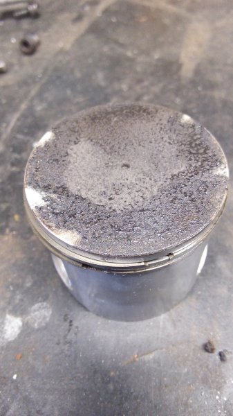

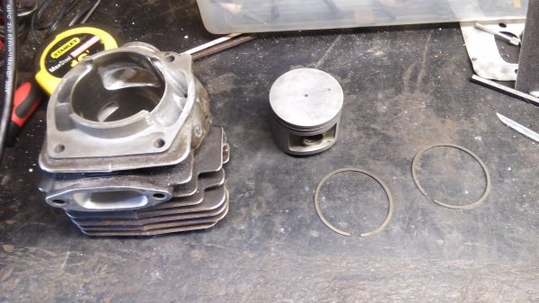

    IMG_20160211_192441.jpg IMG_20160211_192523.jpg IMG_20160211_155400.jpg IMG_20160211_173220.jpg

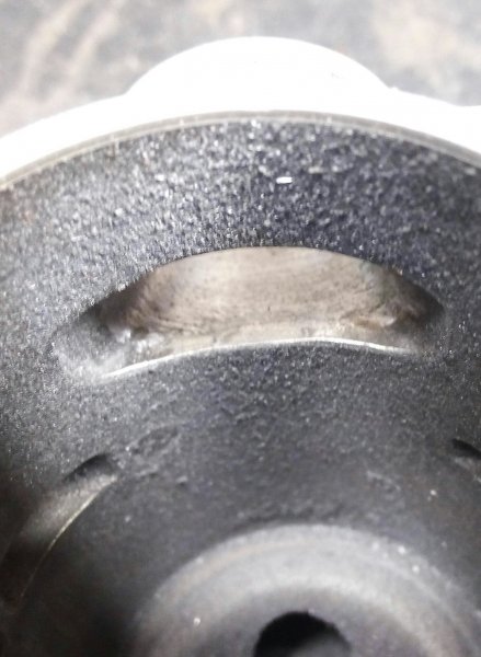

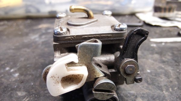

    Thank you fur your input... Well I have run out of funds...so I couldn't get a cutter..so I didn't up the corners. The intake and exhaust are lumpy bumpy...that's about the best I can do with my supplys and materials...I did try and put a bevel on it where I could reach...I couldn't get bevels on the roofs and don't have the funds to get a right angle fur my rotory tool. I run 4 diffent grits through the bore and finished it up with brillo pad. It still has a few scars and so dose the piston. I hand cleaned the top of the piston and used 3 grits of sand paper to clean up the transfers. I used 400 grit on the rings. Thease rings came off the x-torq piston. I did put the cylinder on and pulled it over a couple times...it has pretty good compression. Can I run this cylinder like it is now. Or do I need to do more to it...if not...I am goin to put it together tomorrow and try it. When I start this...do I need to run this ritcher...because of the mods or is it not enough mods to change mixture. Can I run a x-torq carb on this...and if so...is there any gains too it...
    After...
    Is there anything else I can do to it...I am funnin the gasket...couldn't afford the permatect or lock tite... Not that I could find it in a store around hear...there's only 160 ppl in my town...50 miles to a big town and couldn't find it there...lol...any tips, tricks, or comments welcome...thank you friends..

    You can put a small bevel on the ports with your fingers and sandpaper. Bevels will help ring life. I use a round ball for bevels in a straight handpiece.
    R.Singletary and clemsonfor like this.

    Thank you fur your input...can I make one of thease or do you have a picture of the round ball on a straight handpiece..maybe I can make one. Can I use an x-torq carb fur this project...

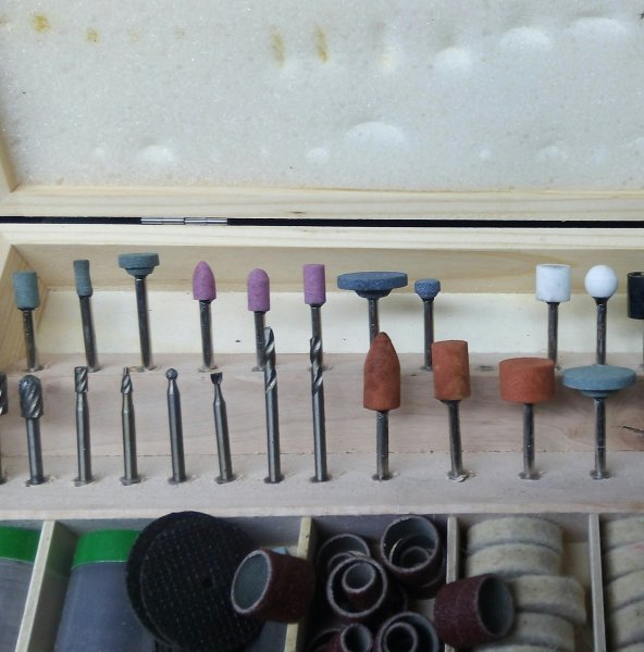

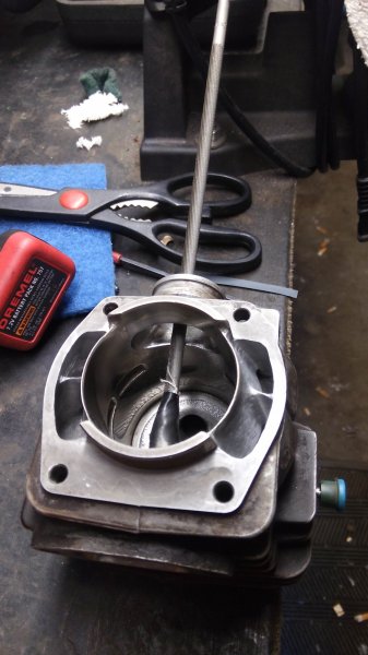

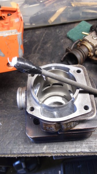

    Will this work to bevel the roof on the exhaust and intake... Thank you... IMG_20160212_082208.jpg IMG_20160212_082508.jpg

    I'm not sure. But I see HF sissors.

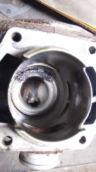

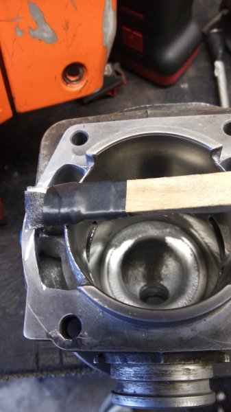

    Ok...I tryed this...dose it look any better... Thank you... IMG_20160212_090214.jpg IMG_20160212_090235.jpg IMG_20160212_090250.jpg

    Thanks fur your input Clem...yes you do and I use them alot...lmfao...thank you...

    Yes. Much better than nothing.

    Thank you fur your input...should try to bevel it more...how do I do the clean up on this and the piston...air and?...gas maybe....thank you...
