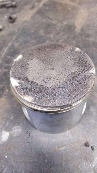

    Thank you fur your input...what would you do with this one...if you was to do it...pad or sand paper....how would you clean the top of the piston... IMG_20160127_111102.jpg IMG_20160127_111006.jpg thank you...

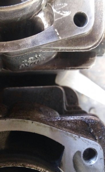

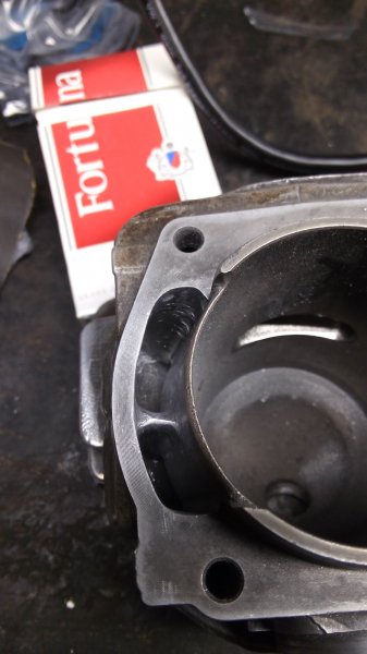

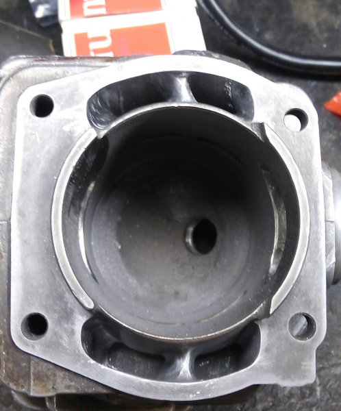

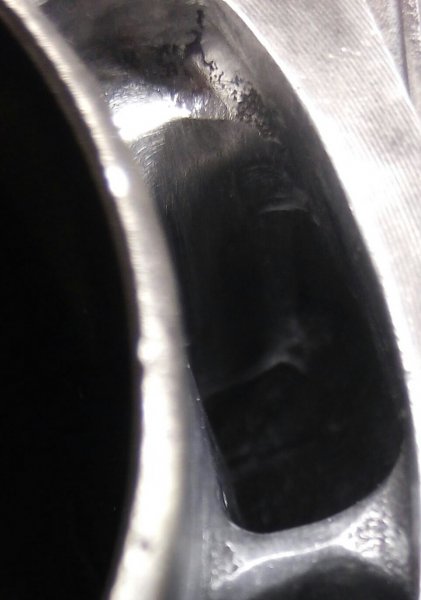

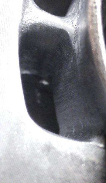

    IMG_20160126_153749.JPG Good mornin friends....I still have more questions... Lol...when I hog this out more...do I make it flush like this one...and can I hog more from hear and to the right... IMG_20160126_153749.JPG IMG_20160125_083743.JPG IMG_20160125_083856.JPG ...to the left on this side and at the bottom... Thank you....

    You want everything smooth transitions. No edges or shelves to disrupt flow.

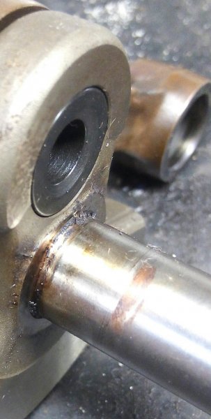

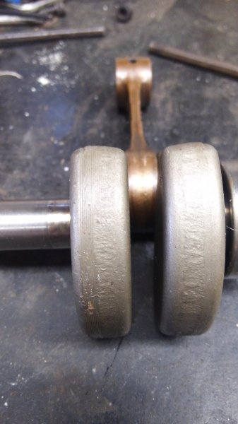

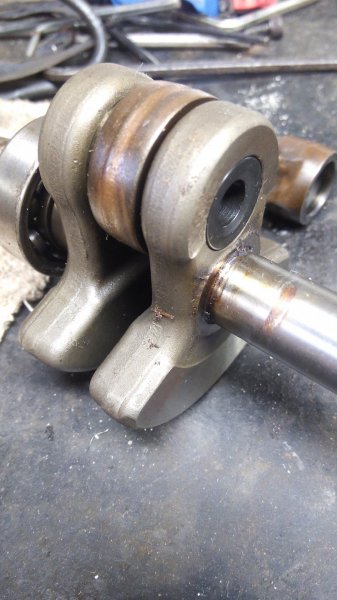

    IMG_20160127_111243.jpg IMG_20160127_185304.JPG IMG_20160127_111315.jpg Ok...I pulled a crank out of a 372xp I tore down fur a rebuild project...how can I tell if the crank and connectin rod and bearin are still good...thank you...

    Thank you fur your input...awesome...thank you very much...

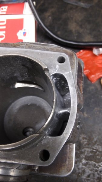

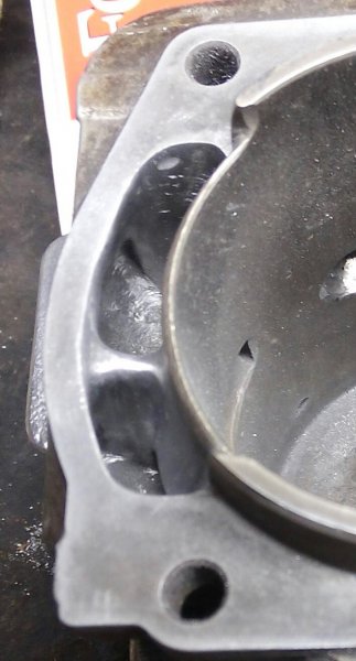

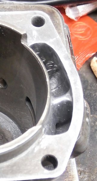

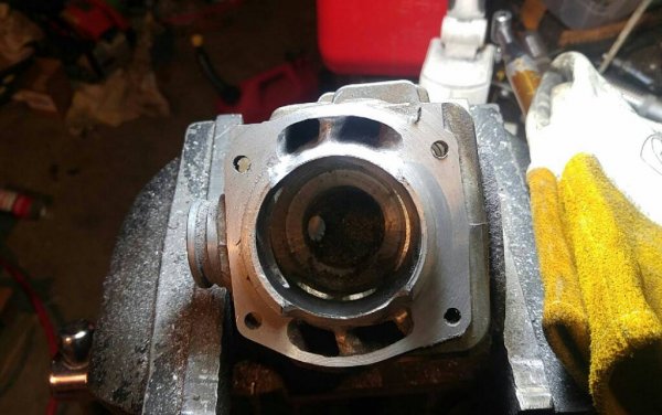

    Good evenin friends,
    I worked the jug a couple of hours today...that's about the best I can get it fur now and fur the tools I have...there still some demples in doth sides.,.one more than the other.... Should I take more out...if so...where at...thank you.. IMG_20160130_181708.JPG IMG_20160130_181740.JPG IMG_20160130_181817.JPG IMG_20160130_181517.jpg IMG_20160130_181535_1.jpg

    Is there any play?

    Soak the piston in seafoam or carb cleaner to get the carbon off the top.
    I'm no saw Porter, but you want there to be no steps or edges in those ports. You're getting there though if you compare to mdavlee's cylinder he showed a few posts back.

    A little play side to side is generally alright but any play of the rod up and down on the crank and the bering is shot.
