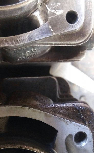

    I know nothing.... But I think I would smooth er flaten out the ridge in this pic.
    clemsonfor likes this.
  2. clemsonfor
    clemsonfor
    15,996
    37,478
    Greenwood county SC
    Isnt that ridge suppose to be there? The factory has it right?
    I think it may have something to do with disturbing air?
    bobdog2o02 likes this.

    Thank you fur the input...oh chit...I hogged on that too...

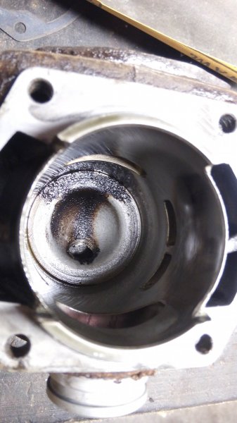

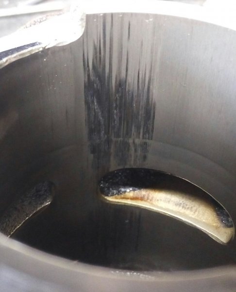

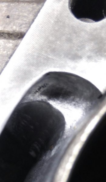

    Ok...I pulled the juck off the project saw...it dosent have humps at all. So will it mater also,at the top of the jug, it is clean except fur a trail leadin to the spark plug. Why is that...thank you... IMG_20160126_152815.jpg IMG_20160126_152924.jpg IMG_20160126_152952.jpg IMG_20160126_153718.JPG IMG_20160126_153749.JPG

    Could that trail be fuel blowin by the rings...thank you... IMG_20160126_152815.jpg

  6. bobdog2o02
    bobdog2o02
    Nov 19, 2015
    3,010
    10,445
    Drury Lane, PA
    I'd bet it's at the back side of the flame head, cooler there and causing oil to condense there?

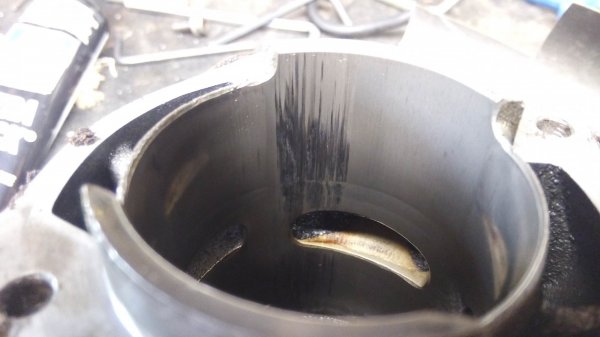

    Thank you fur your input...bad ringss...there is some markin on the inside of the jug...it travels clear to the top of the head.,, IMG_20160126_161728.jpg IMG_20160126_161832.JPG the saw never smoked or had any power loss...

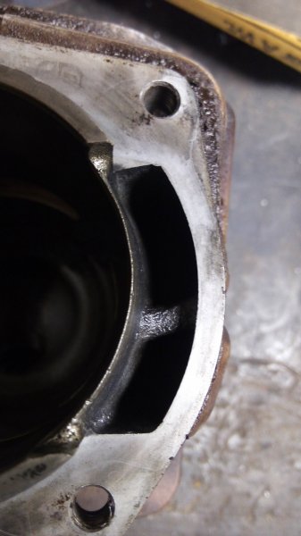

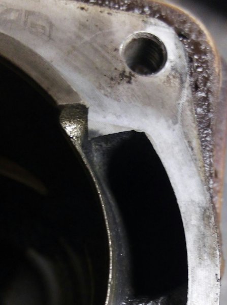

    The exhaust side is hotter. That's part of what causes that build up above. Smooth that hump out in the transfer.

  9. mdavlee
    mdavlee
    Oct 21, 2013
    4,380
    10,479
    Take sand paper to that transfer and clean it up.

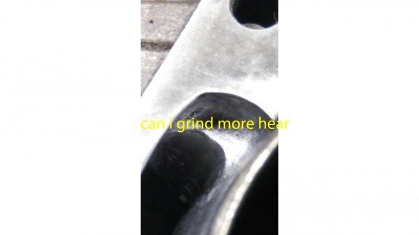

    Thank you fur the input...so take this hump out and clean it up with sand paper...what grit... 1453831493522.jpg

    Yea those are scratches. My saws dont have carbon and junk like that in the head. Bad tune, junk oil?

  12. mdavlee
    mdavlee
    Oct 21, 2013
    4,380
    10,479
    I start with 220 on a split mandrel. You can work up from there and go to scotchbrite.

    Thank you fur the input...so a bad tune or bad oil causes this...or is it the scratches that allow the fuel and oil to blow by the rings...the scratches end at the head where the material begins to the spark plug....thank you... IMG_20160126_161832.JPG IMG_20160126_152815.jpg
  14. clemsonfor
    clemsonfor
    15,996
    37,478
    Greenwood county SC
    The scratches probably end where ever that point of the piston stops?
    Yea bad tune can cause scratches. If your too lean there will not be enough fuel with oil in it to lube the saw.
    Bad oil can cause carbon and crud as it hardens and turns to gunk. Good quality oil stays liquid and does not coke up. Use a good synthetic oil.

    Thank you fur your input...so start with 220...and that is to smooth the shoulder 1453831493522.jpg IMG_20160126_153749.JPG out...should I hog out more of the shoulder...thank you..

  17. mdavlee
    mdavlee
    Oct 21, 2013
    4,380
    10,479
    The 220 is to clean the bore. Smooth that with a carbide

    I am no expert but can you feel the scratches? Or is it transfer ? Some guys lost good videos of removing AL transfer off the jugs.

    Thank you fur your input...mdavlee please have patience with me...lol...the 220 is fur this bore... IMG_20160126_161832.JPG and the carbide is fur the shoulder work on this one... 1453831493522.jpg IMG_20160125_083819.JPG Right???
