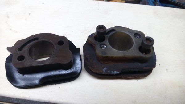

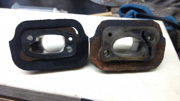

    Nope... The intakes won't inter change.... IMG_20160301_114248.jpg IMG_20160301_114342.jpg but the carbs do...at least I learned that...lol...thank you...
