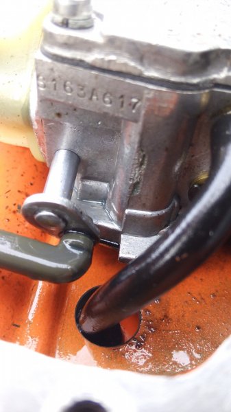

    Afternoon friends...still havin problems with 61...I can't get it to stop slobberin...and now it's blowin fuel out the carb... IMG_20160229_145042.jpg IMG_20160229_145032.jpg I have leaned the Hi out to 3/4 and more...to the point where almost kills the saw...anything over 3/4...the saw bogs....could the low be runnin to rich...is the what cause the gas to blow back thru the carb...thanks guys fur any ideas...

    Gas blowing out is not normal. If the L is too rich it won't idle period. Even at that point gas should not be running out.
    I am not sure if the gasket was damaged or the carb has a problem...is one of the press in fittings like the fuel inlet loose?
    I'd say it's time for a new carb on this saw.

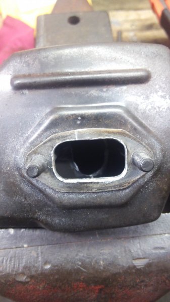

    As for back pressure on the muffler that should not matter? But just for giggles pull out the screen? See if it runs better?? BUT fuel out of thE muffler like that is that it's too rich not really the screen. But it might tune better without it??? But I seriously don't think so.

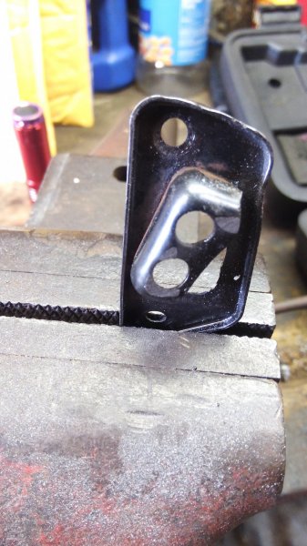

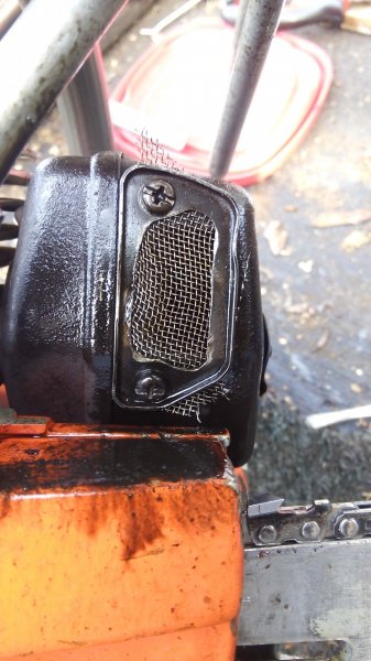

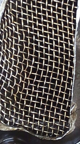

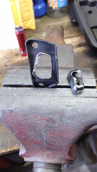

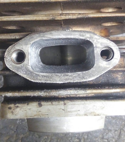

    Thank you fur your in put Clem...the manifold is what looks like nylon...but I am goin to check it...yes I did grind on this one...I opened the in take up a bit and the exhaust....and muffler.... IMG_20160222_190046.jpg IMG_20160222_221949.JPG IMG_20160223_123223.jpg IMG_20160222_175121.jpg it did not leak fuel be for...the air cleaner is bran new.... IMG_20160301_082125.JPG couple of comments back...I said that when I pulled the screen it did run better....I checked it a couple of times...put it on...run it...pulled it off...run it...I put a new screen on it with bigger openins... IMG_20160301_082637.JPG so I opened the exshaust deflector up.... IMG_20160228_123023.jpg IMG_20160228_124517.jpg it still runs a bit better with it off...that's what I was sayin about...I mite put another exshaust deflector to release more pressure....thank you fur your help Clem....

    This is the deflector mod I did and was thinkin of doin one more on this muffler to release more back pressure... IMG_20160229_145032.jpg thank you....
