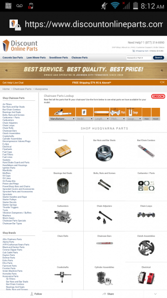

    Has anyone bought any parts from this site...there AM but look pretty good and seem like they have a good invatory. Prices seem good too.... www.discountonlineparts.com Screenshot_2016-02-27-08-12-03.png Thank you...
  8. clemsonfor
    clemsonfor
    15,996
    37,475
    Greenwood county SC
    I buy off ebay. Plenty of China parts there probably as cheap as possible same are directly from maker in China others just china sellers so it's about as cheap as u can get. Cuts out middleman
