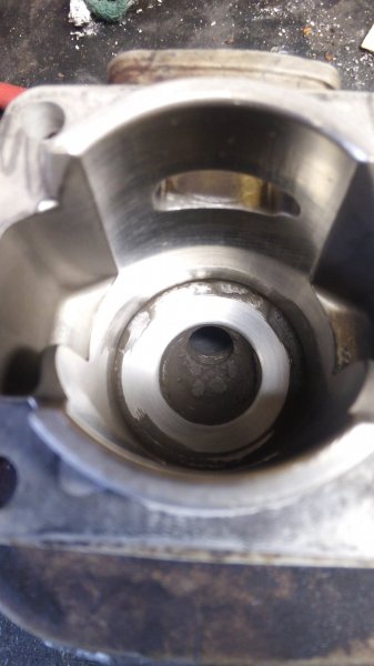

    Seal looks a little deep in flywheel side. The clutch side when you assemble the oiler and sleeve you'll know if it's too high still.

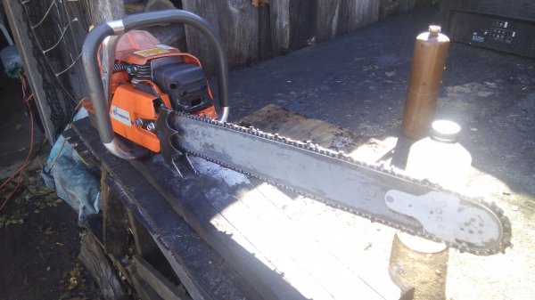

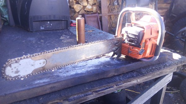

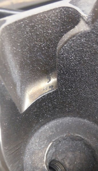

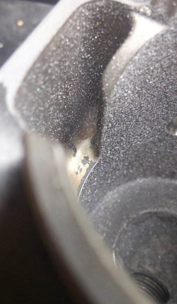

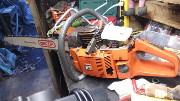

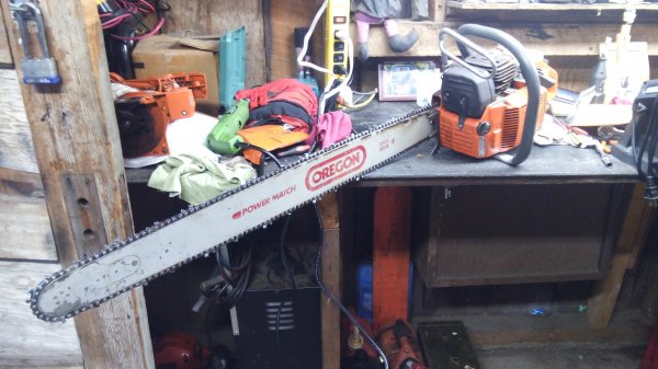

    Thank you fur your input crazy...I did...it seems too run pretty good too...but it is leavin alot of oil in the exhaust... I Believe it is from the mix I am usein...it is out board mix...Clem and md educated me on the mix I need to be usin...hear is a picture of the saw...not very pretty...lol... IMG_20160222_111232.jpg IMG_20160222_111208.jpg This is a hong Kong rebuild...so not sure how long it will run...its the 52mm big bore...I open up the exhaust, muffler and intake...I beveled all ports to...then run 3 grits of sand paper through the bore. I ran the green scoth brite thru the bore...then a white one....thank you fur your interests...

    Nice chain brake!!!:eek:
    You want a wet exhaust but you don't want like wet and drooling allover like a leaky oil tank or anything.
    Use the right oil and hopefully that changes. Cause even my saws mixed at 32:1 and tuned a tad rich I don't have what I would call real oily exhaust. Damp and specks sometimes but not slobbering or oozing oil or anything.

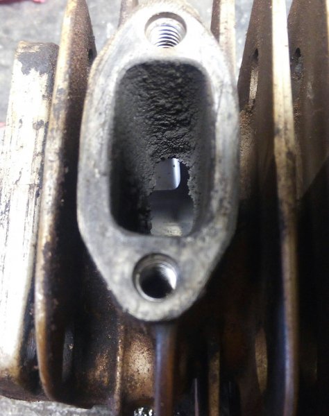

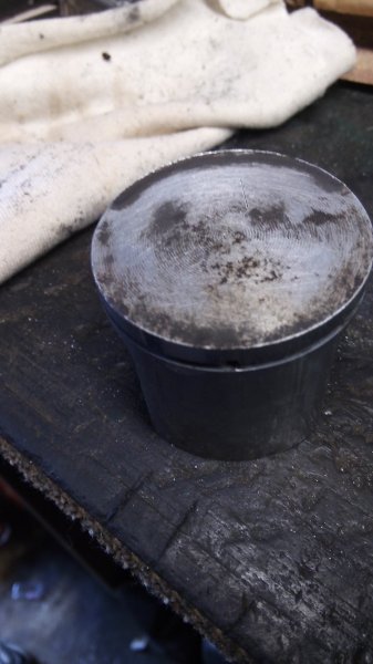

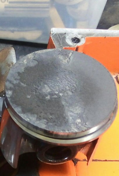

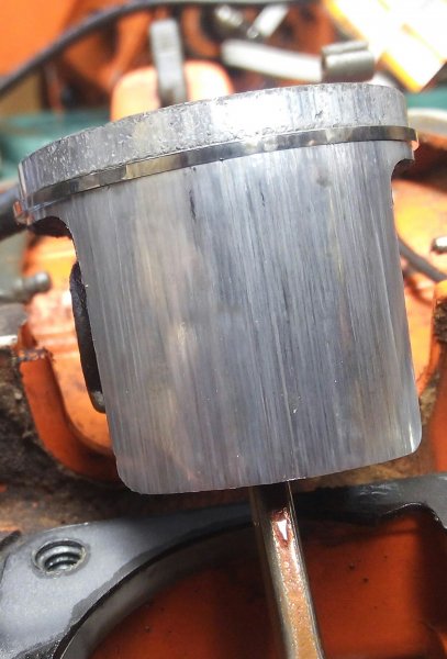

    Look at the crap in that saw!! You guys really need to buy some quality oil. And maybe put some seafoam at a high rate into your mix to help clean up and keep some of those deposits from forming.

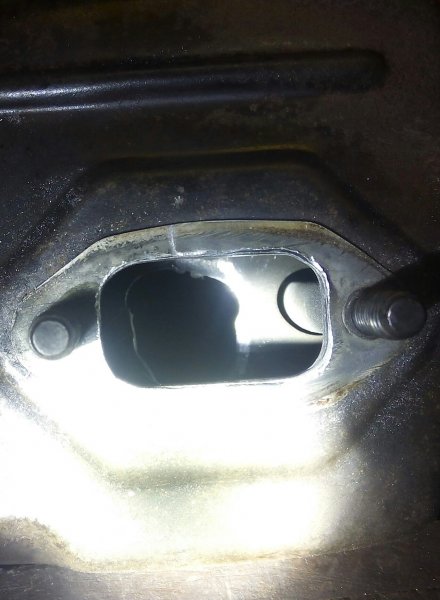

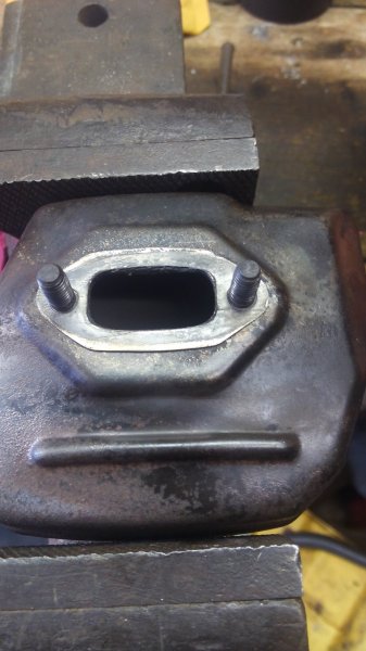

    IMG_20160222_163424.jpg IMG_20160222_165605.JPG IMG_20160222_163424.jpg IMG_20160222_163424.jpg

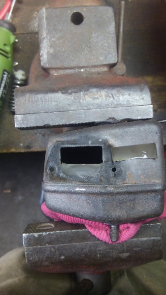

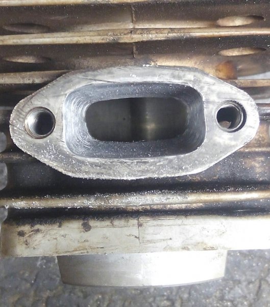

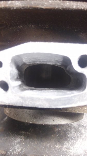

    So if I wanted to hog this out...could I... IMG_20160222_222448.JPG IMG_20160222_222523.JPG muffler mod done...
    Thank you...

    Don't hog that out. It will make the flow lazy and probably lose power.
    Set mufflers is probably tuned too rich. A ported 372 will usually turn 14.5k or real close and still be plenty rich unless milling.

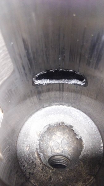

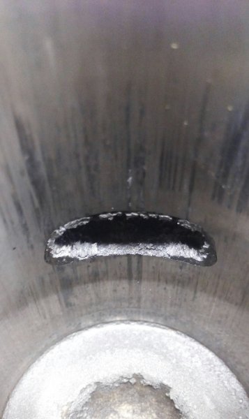

    Thank you fur your input Clem and good mornin...yah it blows...hopefully some work comes along...or my season starts....next time my wife and me go to walmart i will check it out...we only make it to are local walmart every couple of months...its a 100 miles round trip...so any who... I put the 61 together and tuned it...it sounds pretty good and it runs...fur how long I don't know...lol...I tuned it to a 32 in. Bar...it pulls it good...on the jump...when you first pull the trigger...it don't bog...but it dose take a sec to run up...I turned the Hi way in and it screams...but I turned it back down...because I am usein the inboard mix and I used all the old parts...I cleaned up the intake and exhaust, did some work on the boar...removed the transfers the best I could...same thing with the piston...the piston was in bad shape...lol..still is but not as bad...the piston had a big bur on the top on the exhaust side and lots of carbon...I ground the bur off and removed the carbon... IMG_20160223_141340.jpg IMG_20160223_143651.jpg I cleaned the ring up a little... I kitted the carb...what are thease little plugs fur that came with the kit... IMG_20160223_132119.jpg I put a new air filter on...
    Hear is the bore before clean up... after.... IMG_20160221_165507.jpg IMG_20160223_123223.jpg It's not the best...but better than it was...after I did the clean up and pulled on it to start it...it has very low compression... Do you think the ring will seat and gain compression... Or do you think it's just wore out...it is runnin and starts every time...thank you...

    I bet the 61 needs a ring why compression is low. Plus just wear. That top plug is for pulling out to gain access to a passage. And that is to replace it. You put it in and hit it with a punch to seat it. Yours may not have the plug.

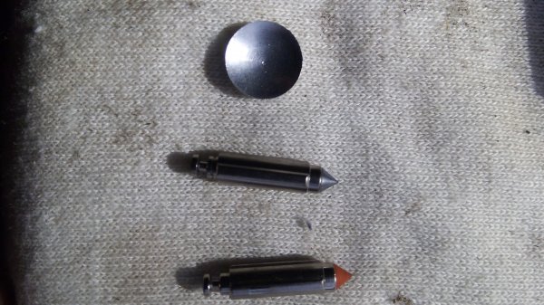

    The bottom two are needles. You should of replaced it in the rebuild. It's under the metering diaphram. Take the screw out the shaft and little metal fork will come up with the spring behind it. And ThE fork arm thing lifts and controls the inlet needle.

    Thank you fur the input Clem...yah I know about the needle and fork...I have kitted quite a few carbs...but I didn't know about the plug...what is the passage behind the plug fur...yah the ring and wear don't help...do you think it will seat any at all...thank you....

    If it's still got tension pressing against the cylinder I don't see why it wont?
    The passages behind the plug are just passage ways to some effect, fuel or air. It all depends on the carb I guess
