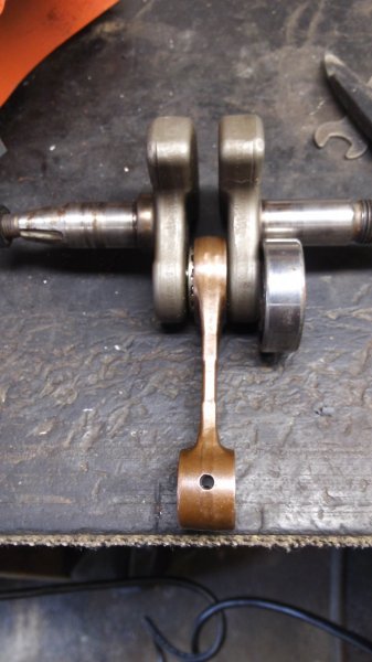

    Thank fur your input Redfin and Clem...ok...thank you...I'm past that fur now...new question... When puttin your seals in...you put then first...then crank and bearins? When I did my 268 last year...I put my seals in first..then crank and berins. But I had heat the case to get the bearings to go in. I was nerves about gettin the seal to hot. I know it's possible... Is the the right to do this...and when I put the bearings on the crank...I heated the bearings and froze the crank...the bearings are suppose to slide right next to the crank right...that's where I made them sit when I put them on my 268..…thank you... IMG_20160217_145050.jpg IMG_20160217_150603.jpg

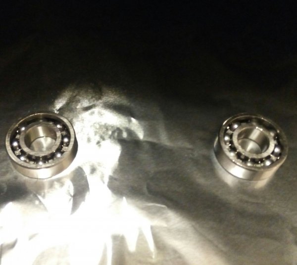

    Oh and how long do you leave the bearins in the oven...the video I watched was never clear about that...all I got of it was you have to set your oven at 150...my oven only gose down to 170...when I did my 268...I don't think I wait long enough..the bearins got hung up...thank you... IMG_20160217_155346.JPG

    I heat the case halved at 325 and drop the bearings in the case first. Then heat the bearings with a heat gun and I can push the crank in by hand sometimes all the way to seated if I'm quick enough.

    How long do you leave the half's in the oven at 325...thank you...

    Half hour

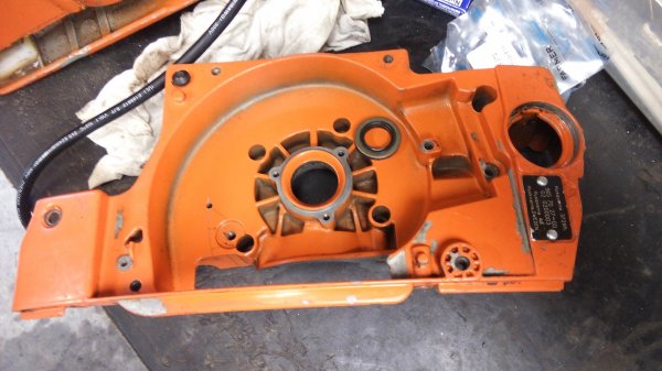

    Thank you fur your input md... It looks like the case has wallord out...wish I would have seen that before I pressed the bearins and close the case up...lol...I need the practice any way...that one gose back on the self...lol...thank you... IMG_20160218_122234.jpg

    That seal only seats close to the top. If you drive it too far it will be loose.

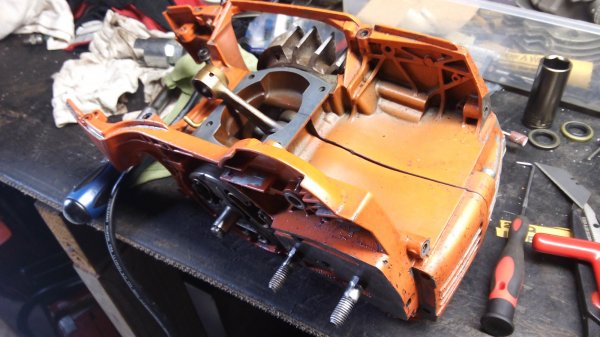

    Thank you fur your input md...nah...I pushed it all the way in...easly...so I am gonna start my next project in a couple days...tear down...rebuild... IMG_20160218_123002.jpg

    They do go easy if they go too far.

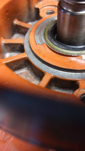

  19. R.Singletary
    R.Singletary
    Jan 14, 2016
    168
    106
    ca

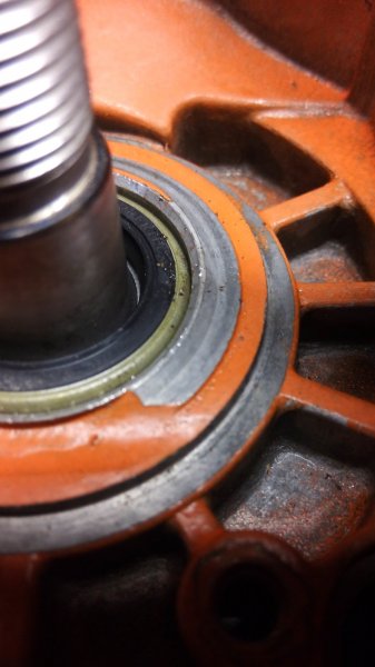

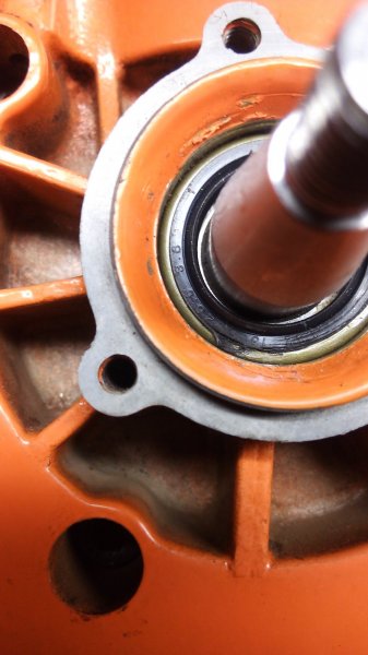

    Thank you fur your input md...lol...I found the problem with the seal and why it didnt fit right....I feel like a dumb azz...I put the seals on the wrong sides...I put the fly wheel side on the clutch side and the clutch side on the fly wheel side...uggggggggggggggg..lol...clutch side... IMG_20160219_125259.jpg dose the seal look like it's too low on this one side... IMG_20160219_125259.jpg fly wheel side .the seal don't even come close to sealin on the shaft... IMG_20160219_183921.jpg live and learn...lol...thank you...

  20. mdavlee
    mdavlee
    Oct 21, 2013
    4,380
    10,479
    It happens. I did the same thing once. I threw all the seals in one bag.
