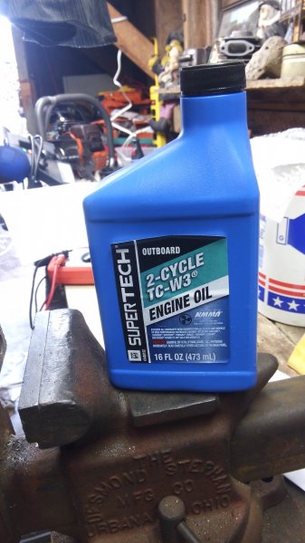

    Thank you fur you input Clem...this is what I have been runnin...is epa smog control...thank you...

    There's your problem your using a water cooled oil in air cooled stuff. It's not designed to operate at the high Temps a saw sees. That's designed for outboards that are water cooled and run way cooler so the oil is formulated differently. Your not getting the lubrication you need out of That and possible why you have some of the deposits you do. It's better than nothing and I would use it in a pinch but that is not recommended for your saw.
    And yes the epa controls emissions on saws which basically is smog control.

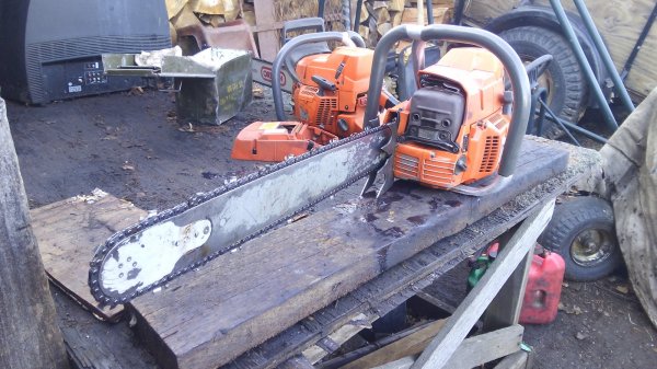

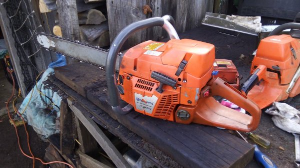

    Thank you fur your input Clem... I got it tuned the best I can fur now...when the funds start rollin comein in...I will change my mix...what do you recomend...that's fairly cheap...is there carbs that I can use on thease 372 that are not epa...dose a epa have less performance than a non epa carb...thank you...

    Use the same carb but just set it richer. Until you go crazy with porting I don't think you need to swap carbs. I'm no expert though. That is good oil...for a boat. I use it in all my outboards. And add to my tractor diesel as well.
    You can get the Walmart air cooled two stroke oil. Look in the air cooled section of the oil isle. It's in the bottle with the little squeeze mixer on ThE top to add the right amout. It's not that much more I don't think.
