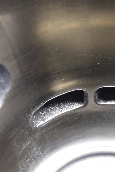

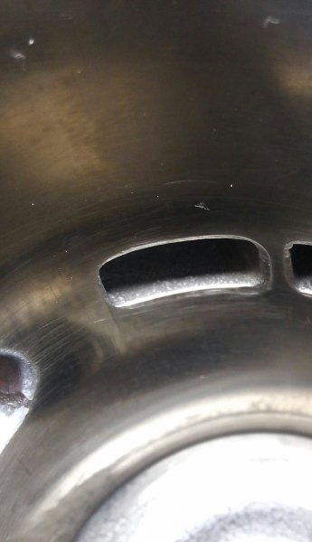

    I do see a couple 90* spots that could use some attention. You really only need to break the corner on the plating when your beveling. It alot easier to do with a round stone or diamond ball.

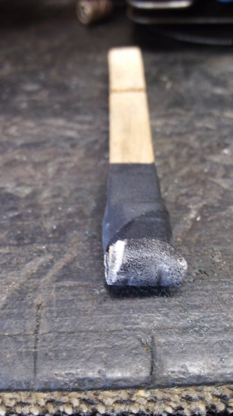

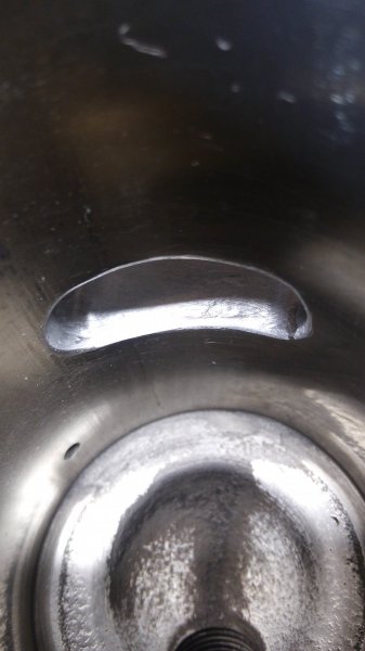

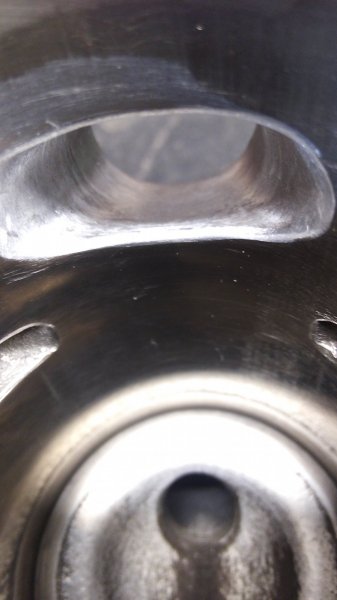

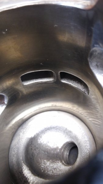

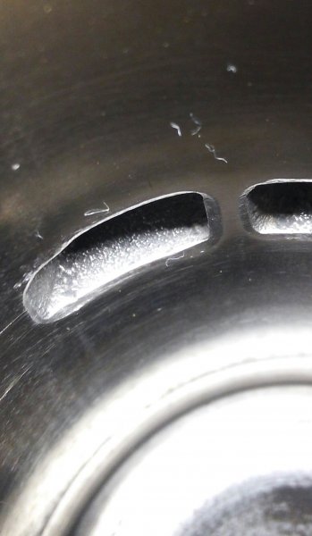

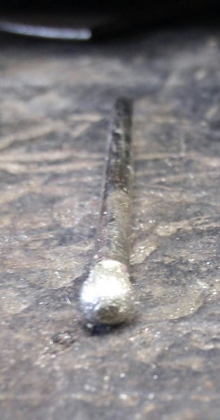

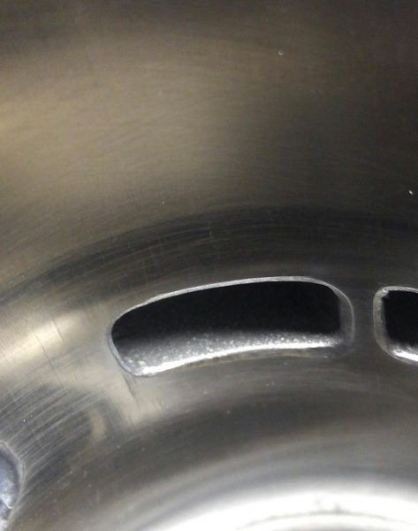

    Thank you fur your input...a couple of 90°...I'm a greenhorn hear...lol....can you exsplain better...I do have a couple of stones and rounded bits.... IMG_20160212_152319.jpg but I don't have a very steady hand...so I used this... IMG_20160212_152659.jpg lol...it was a pain it and took longer...better than over grindin till I get better at it....this is what I got done.... IMG_20160212_153337.jpg IMG_20160212_153407.jpg IMG_20160212_153711.jpg IMG_20160212_153435.jpg What do I do fur clean up now...air and gas...do the same with piston and ring...I want to run a brillo pad thru it again...I used the green one last time...I have white and green...witch do I run thru first...thank you...

    90° angle on the port opening is what I'm referring to. In the pic above on the left side of the ex see how the edge is almost a sharp corner? Break the edge of the plating with the round diamond ball you posted.

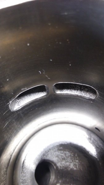

    Thank you fur your input....use this.... IMG_20160212_212735.JPG here..... IMG_20160212_212853.JPG and here... IMG_20160212_212926.JPG ...do you know what brillo pad to use in the bore...I already run the green one...I want to do it again after this little touch up...do I use the white or green brillo... Thank you...

    Good mornin friends...dose this look better....do I need to do more to the 90°s....thank you... IMG_20160213_093707.JPG IMG_20160213_093756.JPG

    Those bevels look good to me.

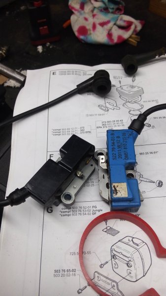

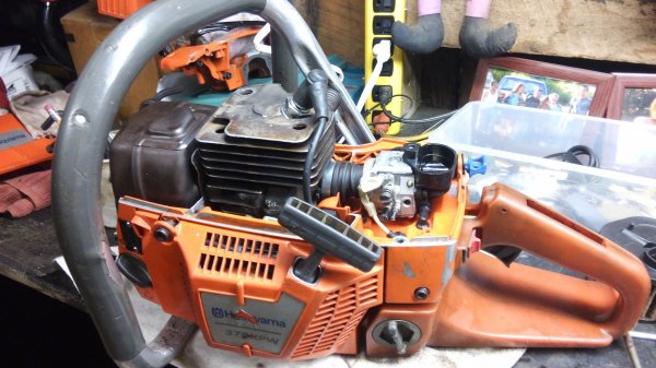

    Got it...it was the coil..I had bought a hong Kong one... IMG_20160214_061319.jpg I put the stocker back on it...a little primer..BAM...it fired right up...I have to wait to tune it tho...the niebors probly wouldn't like hearin me rev this up at 6:30 in the mornin...when I tune this...wear should I set it...I have the Hi at 1 1/8 and the Lo at 1 1/2 with the air filter off. I will be runnin a 24 in. Bar...thank you friends fur the support...help... and patient with this green horn... IMG_20160214_062353.jpg

    Start from there but set it where it needs to be. And pit the air filter back on it as you will be running with one and it creates restriction.
    Nice n clean!!
