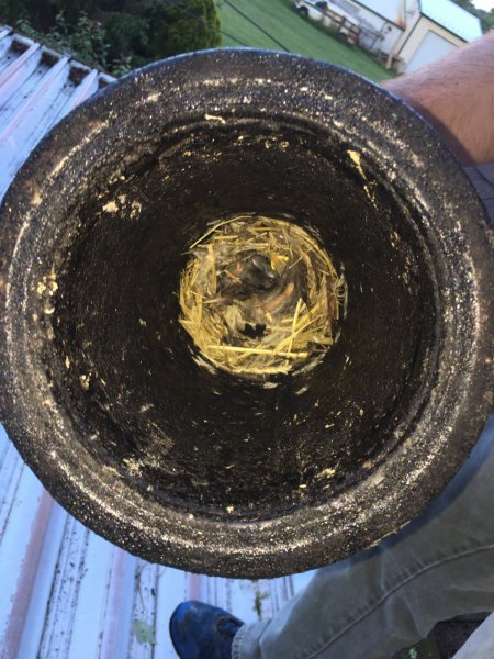

    So after what, 11 years of wood burning, this happened last week.

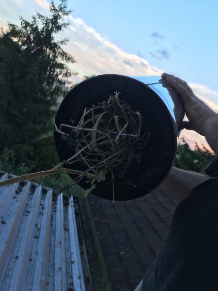

    We heard a bird feeding it’s young in that direction and sure enough a starling flew out. So I, like a dummy, throw a couple noodles in the stove hoping to smoke them out. No bueno. So I go up and have a look. damm it! Cutting that big ugly maple down across the street made them migrate to my stack!
    So I removed the top section to clean it out. The smoke did get to the young. I don’t feel any remorse for starlings. Nasty nest robbers they are. Pulled out the material and it had to be at least 10” of packed tight stick/straw/stuff!! Nesting went up to my hand in the second pic. Unreal.
    So now I might need to find something to prevent this from happening again. Any ideas? I’d rather not go up twice a year to cover and uncover.

    Much as I hate the stuff, a length of 3/4" sq mesh around the top prevents the intrusion - course it does load up and needs to be cleaned if not removed at start of burn season.

    This...or I'm not so sure its even called screen...perforated metal I think, in stainless.
    My caps have holes big enough that some birds could get through, but they don't seem to mess with it...and its not so restricted that it gathers buildup causing draft issues. I've had that in the past though, 1/2" holes I think it was...too small for sure!
    Mine looks kinda like this...only the holes are more square.
