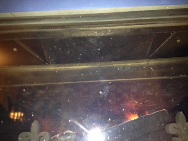

    The secondary air plate that forms the roof of the firebox ends about 7" from the front of the stove and the flue gases exhaust in the front top of the firebox into the channel that holds the catalyst. So the actual angle of the roof of the firebox probably hasn't been properly calculated yet here.
  15. BrianK
    BrianK
    3,108
    11,113
    West central PA
    The roof of the firebox starts about 7" back from the andirons/door. So the rise from 11" at the rear to 15" is steeper. The space in between is open for the smoke path to the cat.

    Here's a better illustrated explanation of what I was describing. [​IMG]
