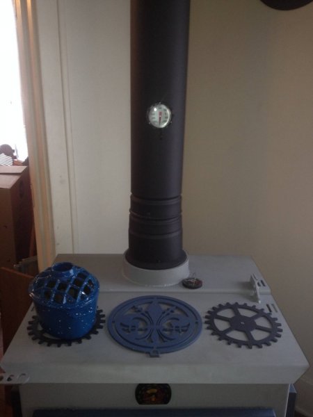

    Just get the flue up to cat temp and engage the cat like the Fireview. We usually aim for 300 on the flue. Now that I have the Bacharach probe thermometer installed, that will be easier. Up till now all I could do was shoot the 8" to 6" reducer with the IR thermometer.

    No cat probe. I just installed a Bacharach probe thermometer on my double wall stove pipe 18" above stove top.
    We just got done moving the stove and hearth pad 4 inches out into the room because the left side wall temps were making me uncomfortable (they hit 150.5 on the IR thermometer during one hot burn earlier this week. That's still well below the UL approved levels of ambient room temp plus 117 but I'm being overly cautious.)
    Its 37 out here right now.
