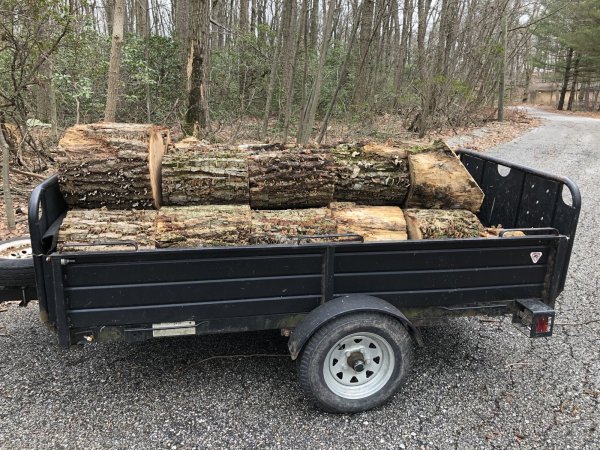

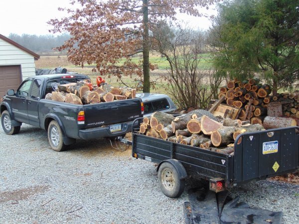

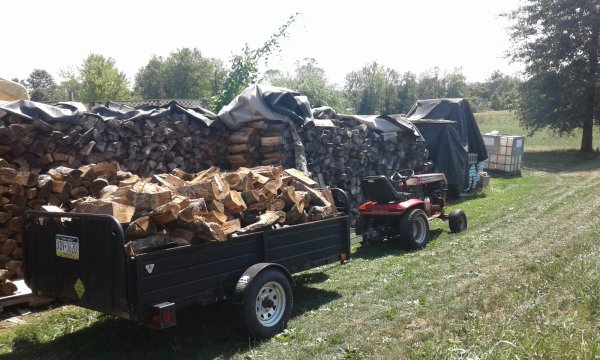

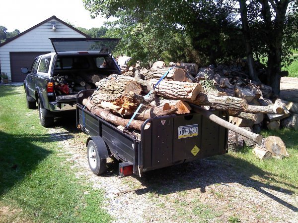

    Can’t really hammer down when I got this trailer but it was many years ago. Got my Tundra in 2010 so it wasn’t long after that. Probably 15 years or so ago. I’ve showed it absolutely zero love in all that time. Here’s some of the good loads:
    :whistle:
    2014:
    Anyway..

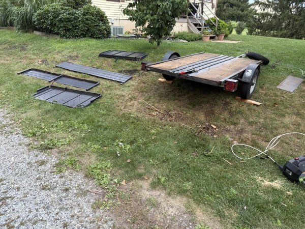

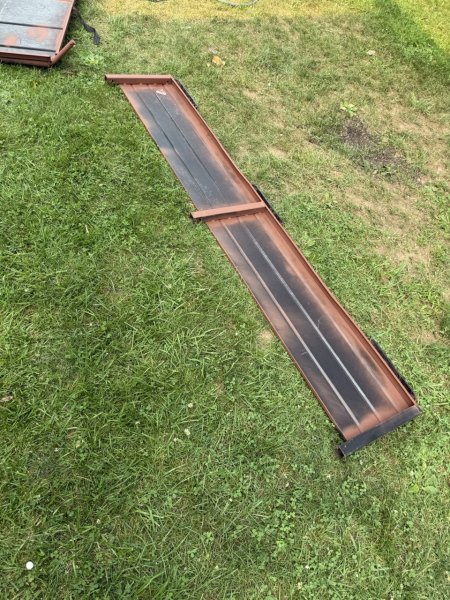

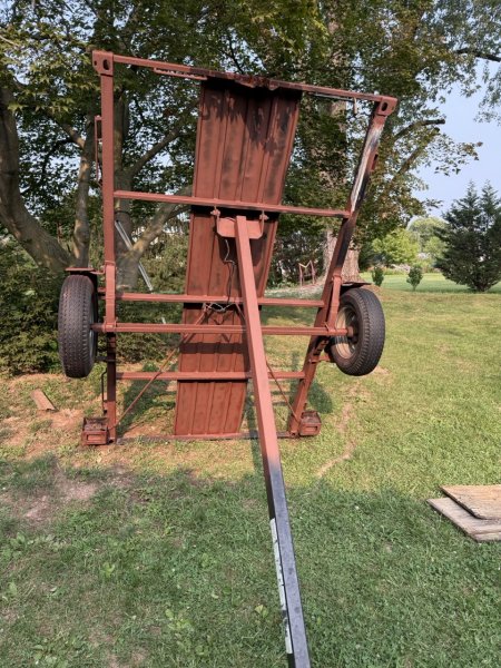

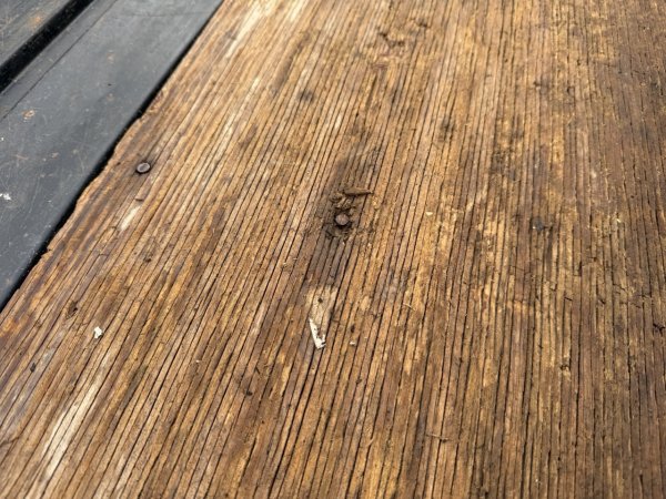

    2 things motivated this. First was the right side light was not working and second the morning of renting the boom lift, I had a mishap trying to move it. I slipped on some plastic that was wet and under my feet, the tongue slammed across my leg as I lay helpless. :picard: Really though I broke the fibula. :faint: This made me want to add a swivel jack. Decided to show it some more love than just those 2 things. The original wood was rotting, side marker lights were trashed long ago, it was moldy and rusty. Took some pics along the way, hopefully they will work.. as I found a “hack” on my iPhone to batch “resize” by saving to the files folder. Let’s see if it works;

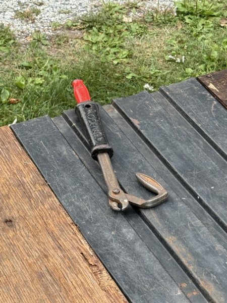

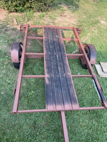

    Got the trusty nail puller out in hopes to get these out. No bueno. I had to use the grinder.

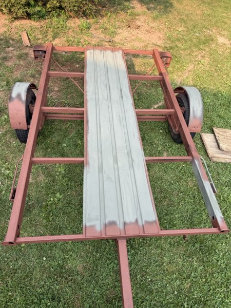

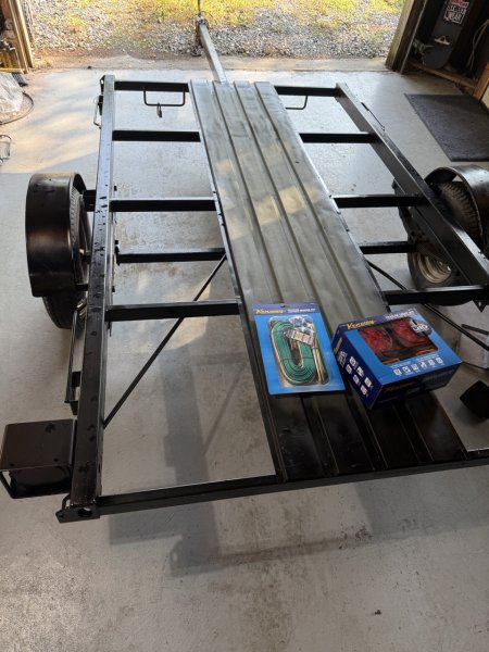

    Trip to the local ACE for stuff. I’ve had really good results with the “professional” Rust-Oleum on the underside of my mower deck so I’ll stick with it. Figured I’d try the rusty metal primer as I didn’t plan on going crazy with a wire wheel.
    Used up 3 cans of black and needed another. Did the lights/wiring next.

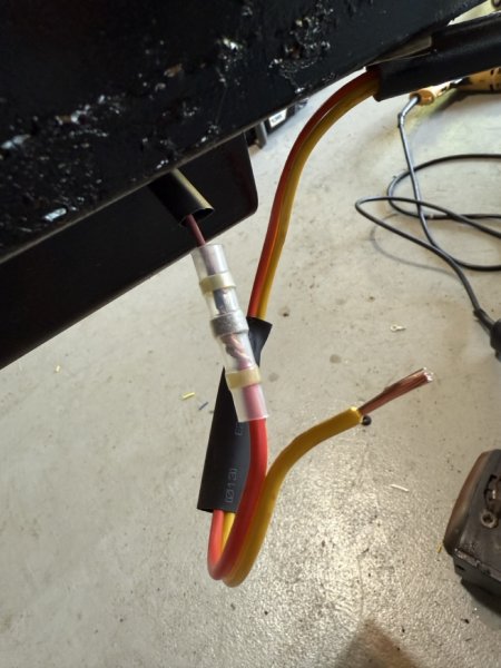

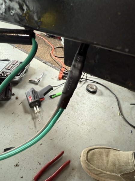

    Solder, tape, shrink then double shrink. OCD kicked in.
    Then I remembered I had some of these fancy shrinks with solder and weather seal built in.

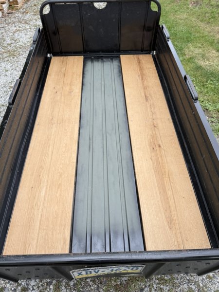

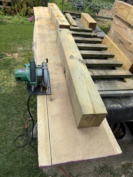

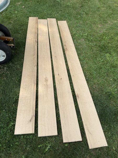

    Next was wood replacement. Instead of buying a $60+ sheet of treated plywood, I pulled some slabs of oak out of my wood rack. These are chestnut oak from my oak honey hole. Not quite wide enough in one slab so I made two boards per side.

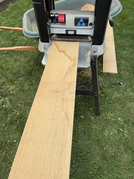

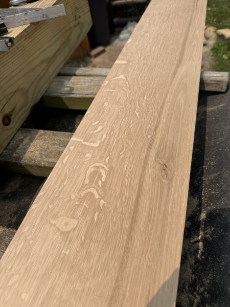

    Sheesh, this is too nice for trailer duty. Too late.
    2 wheel barrows full of planer shavings.

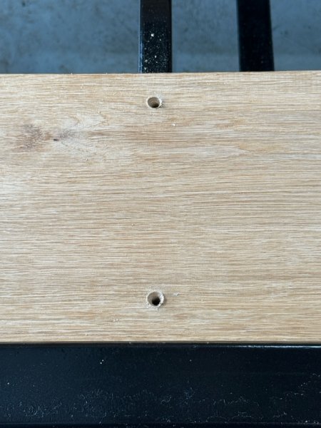

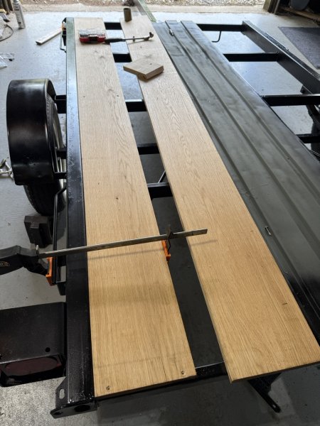

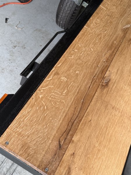

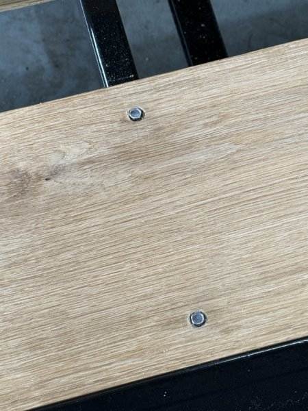

    Next I coated them with Thompsons Waterseal. Then screwed down w/ stainless self tappers.

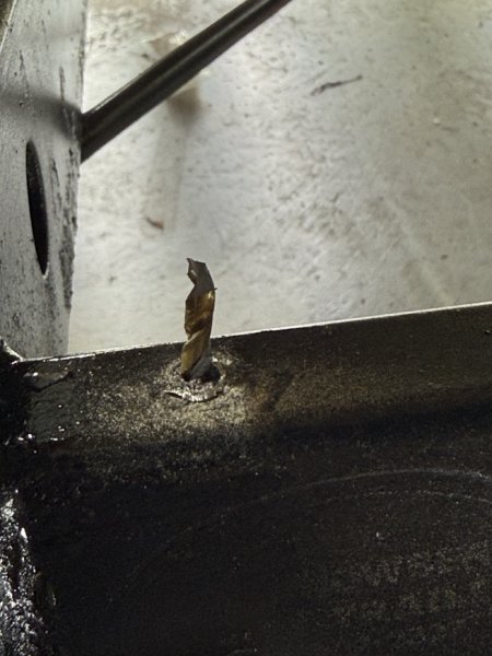

    Only broke 3 bits. :headbang:

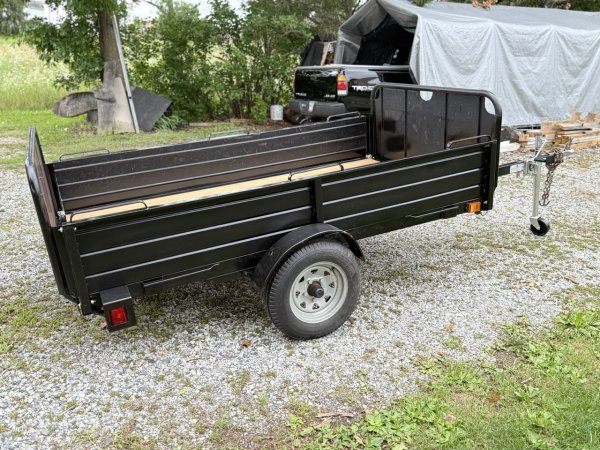

    MUCH better.

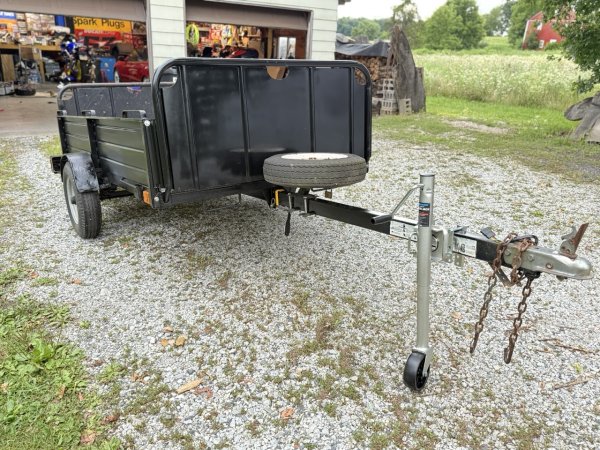

    Wheel jack will be appreciated greatly!

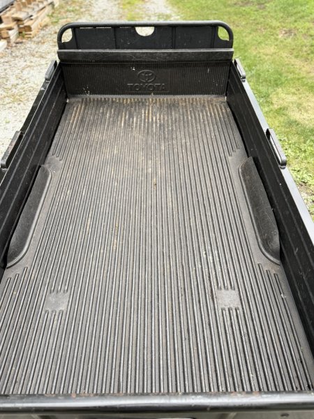

    Had to throw the bed liner back in. Hate to cover up the nice wood!
