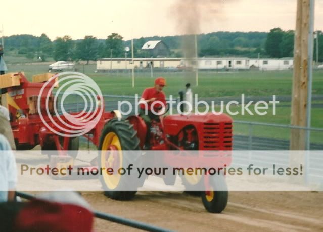

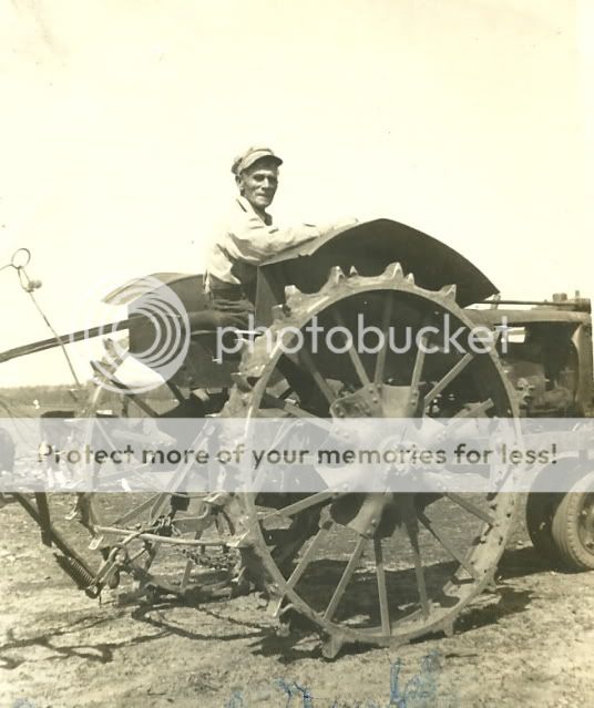

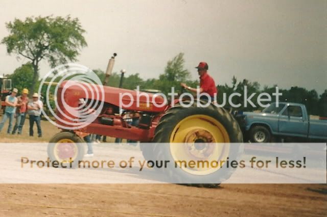

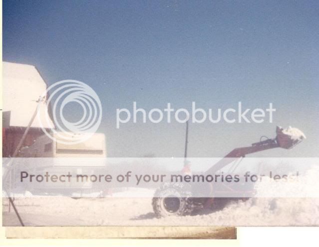

  11. J. Dirt
    J. Dirt
    3,488
    18,347
    Whose in the black and white picture? What is that tractor by the way?

  12. Flamestead
    Flamestead
    Dec 7, 2013
    2,167
    10,974
    Windsor County, VT
    Hadn’t thought of it stopping the tractor from rolling, but that would be a neat trick if it could!
    Knowing people who have died from tractor rollovers makes me take it a bit more seriously.
    Nice pics!

  13. Well Seasoned
    83,790
    X2- hilly here as well so I'm making it a habit to wear it. I rolled the atv one time, -well it flew through the air and landed on me, not something i want to experience again.
    I remember sitting on granpa's lap on the same tractor as the first 2 pics. :yes:
