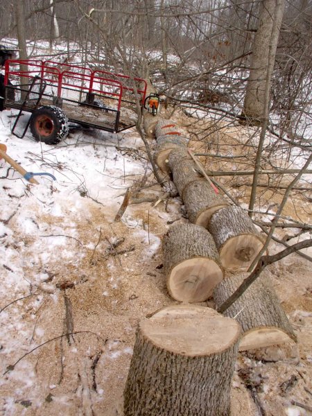

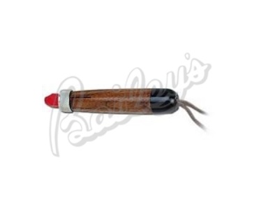

    Low key but it works well. A 4' stick (furing strip, dowel, broom handle, branch or anything like that), and a carpenter's crayon. I do like using a crayon holder that is nice and it keeps the crayon from breaking. The measuring stick measures three 16" pieces. If it breaks or is lost it is easy yo replace.
    Sometimes the crayon does not work well if the logs are really wet so then I simply use the axe to draw a line. Works like a charm.
    Here is the marking stick laying on the logs..

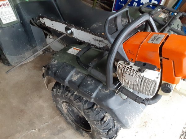

    I stole an idea from a YouTube channel. I have a heavy zip tie attached to the handle of a couple different saws. I measure from the bar out 16" and cut the zip tie off. Line up with the end of the log/last cut and commence to cutting. It's super consistent and folds out of the way when I don't need it. If I'm using a different saw, I keep chalk and a tape measure in a tool box on my trailer.
