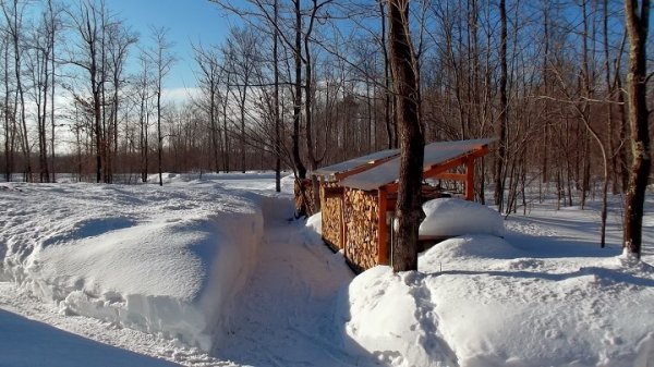

    Each species of wood dries differently. Some people will cut, split, and stack oak in a nice sunny and windy spot, keep it top covered and it can still take 3 years ± to dry to <20% moisture... I have some aspen or white poplar that I got for free. I cut split and stacked about a year and a half ago. It's been drying in a a covered rack and is ready to burn.
    Many hardware stores carry an inexpensive moisture meter. Most people here will tell you to try and burn wood with a moisture content of under 20%. You'll get better stove performance, and a cleaner chimney with dryer wood!!
    I don't think many people will tell you that your wood will get too dry if you split it and it sits around a long time before you burn it. More than likely you'll try and burn too wet of wood...
    Keep your wood dry and off the ground and it will be fine for many, many years.... Good luck and welcome!
    A couple of my top covered oak piles.......
