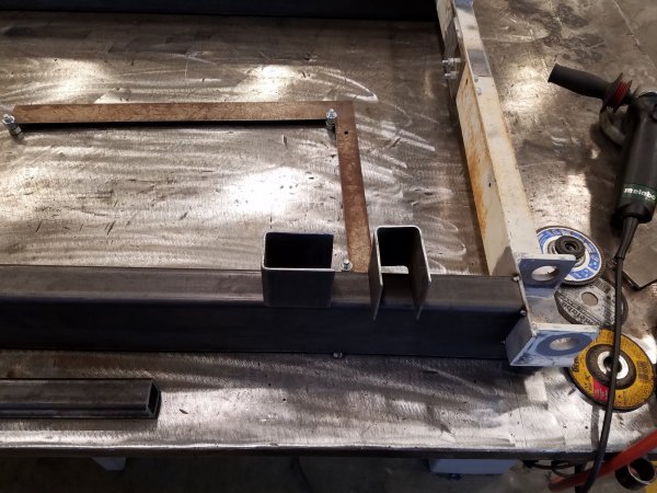

    20170130_140120.jpg Nothing to do with firewood, but with the welding and fabrication you had made references of before. Note the framing square has fasteners attached to it. I do this to hold it up off the table above the round corners of the steel, and it also helps in that I don't need an extra hand to hold the square up to whatever I'm working on. Another plus it that picking the square up off the table is much easier when it isn't laying flat. You may never use this trick, but it may help you come up with another trick that you can use sometime.
