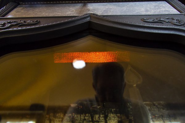

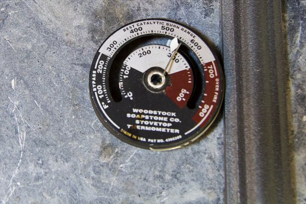

    I reloaded this morning, and after charring the wood I settled down into cruise mode. Airdraft setting at 1, little to no flame in the wood, but just some orange coaling in progress. I love it when the cat is working like this.
