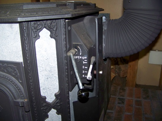

    Regarding the visibility of air control adjustments, someone on the old forum did this with high temp white paint and a fine paint brush:
