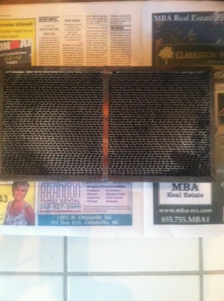

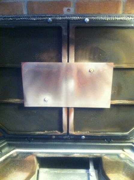

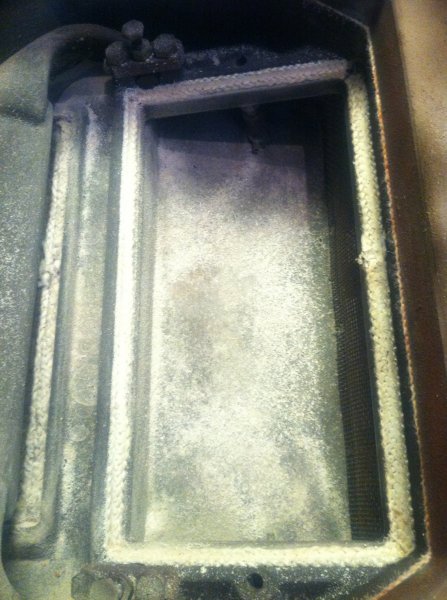

    Decided to let the stove go out yesterday so that I could do a mid-season cleaning. I am still below a full cord burned for the season. Cleaning the cat of my Hearthstone was a tedious cursing event as it required I extract it from the back of the stove in tight quarters operating blind - just hated it. Another star for the Fireview ... so much easier.
    Only a small amount of fly ash on/around bypass cover, no creosote on lid

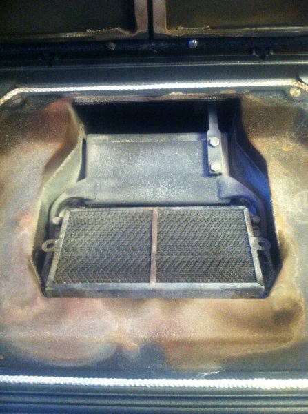

    Fly ash below combustor on top side of scoop
    Top side and bottom side of combustor; only small amount of fly ash on bottom, cells completely open.

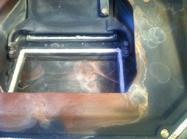

    Looks like liquid stains; not sure how and when these occur as any moisture should be steam when here. What say the experts?

    Mid season? I hope you are right but fear you are wrong on the mid-season.
    You got me on what the spots are. Not seen this before especially where it is. However, I doubt it is anything to be concerned with.

    I don't like the looks of those stains at all. It looks like water got in there and has been sitting there long enough to do some pretty nasty staining. What I can't tell from the picture is if it has gone down through the paint, or if that is just a brown stain on top of the paint?
    I know in my house, any time the woodstove is not active for more than a couple days, it becomes a new opportunity to act as a plant stand.. and my wife has been caught numerous times over-watering and hence staining the top soapstone. But, in your case the only way water is going to get down into that location is around the perimeter of the top frame and through the gasket material. Which just doesn't even seem possible. Especially in a fairly new stove.
    So some questions? HOw old is this stove? Did you buy it new? Was it not like that originally? ...just trying to figure out how it got some water in there. I seriously doubt it has anything to do with moisture content in the wood.
    Can you brush that stain off with a bristle brush?

    The cast piece under the lid is not painted. Only the thermometer goes on top of the stove. This staining is a result from the combustion (somehow).
    Brand new installed in May. No, it was not. This has happened as the result of combustion. All my wood is dead standing cherry, elm and long dead oak. It all measured under 20% with most of my cherry at 15% and the elm just a few points higher.
    It is just surface.
    I consider it an oddity at this point. Not concerned at all, mostly just curious how it could happen. My stove is still under warranty even though it is past 6 months. Since I had the smoke leak issue, I can still return the stove until me and WS agree we are past the smoke issue to both our satisfaction. I need to send WS a follow-up regarding the smoke issue and will send them this picture to see what they think.

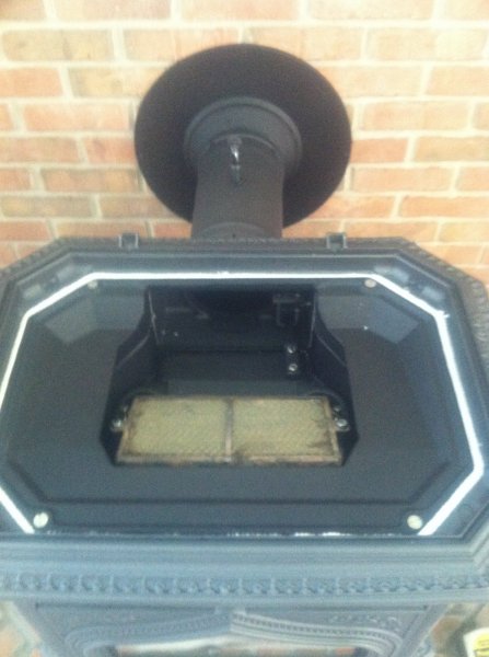

    Here is what it looked like at install:
