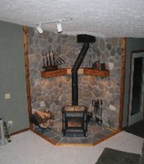

    3. I'll post a pic of my install the Woodstock released when I did it. There are things I'd do differently if I was doing it again, but you make the best decisions you can at the time, and learn later what you like and don't like. Stove pipe comes out the back into a T, then straight up, except for the tow little angles you see in the pic below. Maybe 30 degree angles that were necessary, as I tore a fireplace out of this corner and replaced with the fireview. Double walled stovepipe. Maybe 7-8 feet inside the room, and about the same again in the chase, for a total of 15' to the chimney cap. Back then, I insulated the chase, thinking it would help with draft. It's a big chase, and I had plenty of room to do it. I'm not sure it was worth the effort, though. Stove drafts very well, and when I'm loading, I don't see smoke coming into the house, a slight smoke smell for a minute afterwards, at most, but not every time. Air intake is outdoors air, but I've disconnected, and used indoors air. I cannot tell a difference between the two settings, either in the way it burns, or house temps.

    Looking at that doorway, your ceilings look to be 8' tall. The interior pipe is 5-6' vertical plus another 7-8 or so chimney, minus what you have for bends which is the 90 and two 30s, you might only have 10' of equivalent chimney height. No worries about overdrafting.

    That's a nice installation, those mild bends are not a problem at all. I may have more chimney height that you do, but it sounds like you have a good draft. You have 2 less 90' bends than I do and lined chimney. I'm sure you have good burns going. I don't like that air control behavior. First time I've ever heard about indents on a Fv and it sounds like something might be slightly loose or out of adjustment going on there. Might want to run that by someone at Woodstock. Every once in a while I need to adjust the cat engagement lever, but I've never had to adjust anything on the air intake. Also, although I frequently hit that 700'F mark, it never stays there all that long. It'll get up there, stay there as it gasses off for maybe an hour or so, and then gradually decrease down into the 4oo to 500 degree range for a couple few more hours and then slowly drop down to 200. Depending on the tiime of day and the temps inside and out, I'll let it turn those coals to fine ash for a couple hours before I refill. I'm pretty much on a 3 loads per 24 hours schedule.

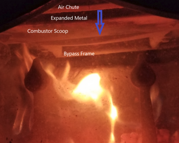

    I was getting good temps out of the stove this weekend, but still wasn't getting the same burn time as some others have been talking about here with the FireView, so I had a conversation with Woodstock today, and they pointed out another potential issue for my performance lagging, which is a warped Bypass Frame.

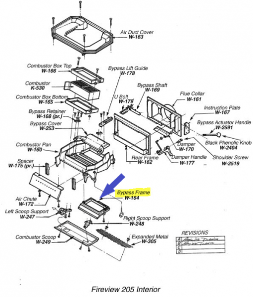

    Sure enough... Mine is warped, allowing gas to gas bypass the catalytic combustor, and exit directly up the flue. This pic is from me laying down right in front of the stove, and looking up at the top of the stove through the window. Flames a bit high, in order to provide lighting. The arrow is pointing towards the warp, and gap that is letting gas escape.
    The guy I talked to likened it to a shear pin of sorts. In the event of an overtemped stove, it's designed to fail before the combustor pan. A heat shield of sorts, I suppose. I asked him if it was evidence that I'd overtemped the stove, and he said that if a customer replaces it after 2-3 years, then yes, but since it's lasted 12 years / ~36 cords of wood, probably not. I forget the exact price, but seems like it was under $30 for that and the gasket. Looks like it's only a couple of bolts to loosen, in order to replace it. Thinking I'd better find my penetrating oil, since they've been in the firebox for this many years.

    Access from inside the box. It's bolted into the bottom of the combustor pan. You can see it by comparing the straight edge of the combustor pan against the edgte of the Bypass Cover. May need a flashlight. You may not be able to see it if yours is straight. I don't think it's something you'd see if you weren't looking for it, because of the low angle you have to look from.
    Woodstock switched from a cast iron combustor scoop that was held in place with bolts to a stainless steel one that is held in with cotter pins. My 2010 stove came with the cast iron one, and I had to replace it a couple of years ago for the same warping issue, and they sent me the stainless. It must have been stainless steel by 2012, if you have the cotter pins at the top of your stove. The explanation they gave me was that they switched to stainless, due to the lighter stainless allowing the cat to heat up quicker. I can see that... The cast piece I pulled out weighed several pounds, and I seem to remember the stainless one weighing several ounces.
