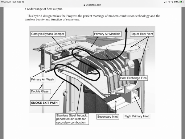

    Where are the secondary tubes in the PH?
  15. jo191145
    jo191145
    7,230
    50,409
    Ct
    No tubes per se but this is a diagram of air circulation.
    My concern would be with adding extra air. Not unlike cracking open the door with the bypass not engaged.
    Don’t get me wrong. I’m all for experiments. I once installed a secondary burn system in a non cat stove. Couldnt maintain a nice burn but I on.y had six feet of flue pipe on top. Just not enough draft to effectively test anything I think.
    Had a 201 also. Just would be aware there’s little preheating of the air feeding the cat. Think that’s why they reengineered that stove in later designs. Adding more air could be counterproductive.
    Hey, try it. Nothing ventured nothing gained. Just keep in mind you may end up cracking the cats if they’re still ceramic.
    BCB and brenndatomu like this.
