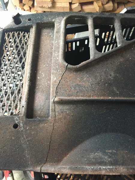

    Time to order a new baffle :( I was cleaning out the top of the stove this evening and noticed a long crack on the baffle near the cat cover.

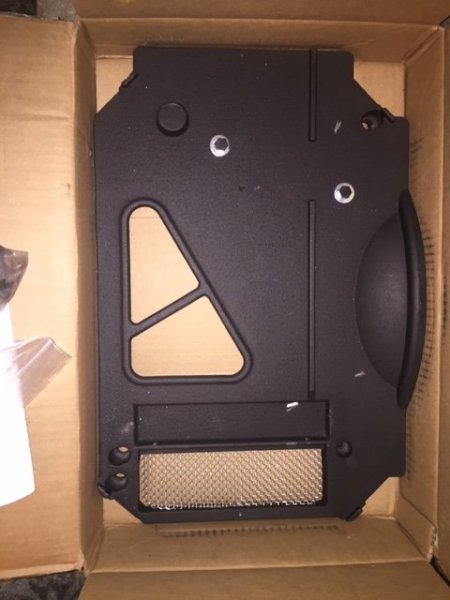

  7. BCB
    BCB
    Sep 29, 2014
    1,315
    6,787
    USA
    New baffle arrived the other day. Not looking forward to making a mess tbh lol.

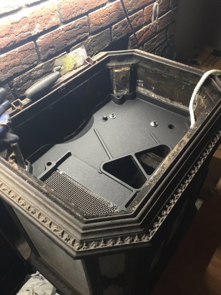

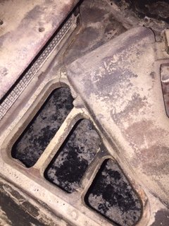

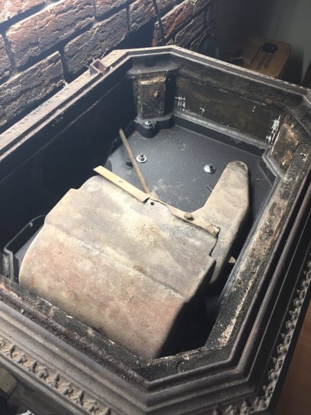

  8. BCB
    BCB
    Sep 29, 2014
    1,315
    6,787
    USA
    Installation day for the new baffle. Mid-60s and rainy so no outside work today.
    I took a pic of the old one so you can see how bad the crack was.
