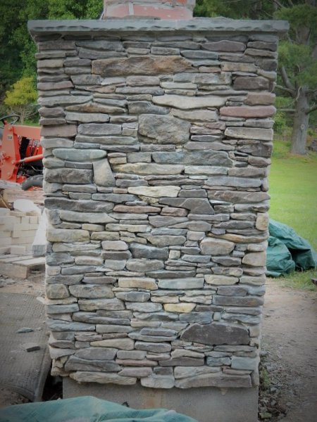

    little peek. painfully slow, but real happy with the way it is coming out. i have done the other 3 sides to nearly the same hieght.

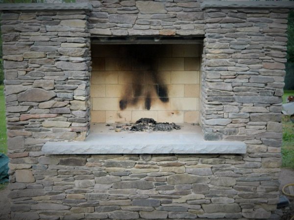

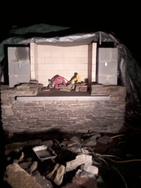

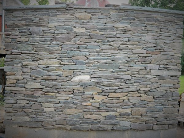

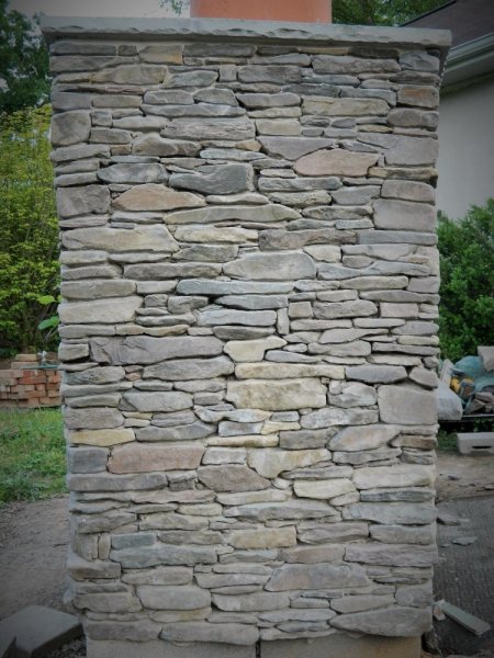

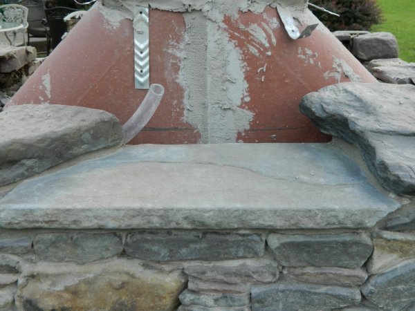

    DSCN0228 (2).JPG DSCN0229 (2).JPG DSCN0230 (2).JPG DSCN0231 (2).JPG DSCN0232.JPG
    As you see there has been a couple small fires to temper the fire mortar and brick. There is still stone work going on above the blue stone shoulders. Last photo shows what will be a water fall ledge that will run down the middle of the rear side, into a pool.

    How will the water feature affect the stone/mortar, or is it not an issue?

    Just a light trickle like in a heavy rain. I don't anticipate the water affecting the stone or mortar. Just have to remember to drain the system come wood burning season. Wood stove season, that is.
