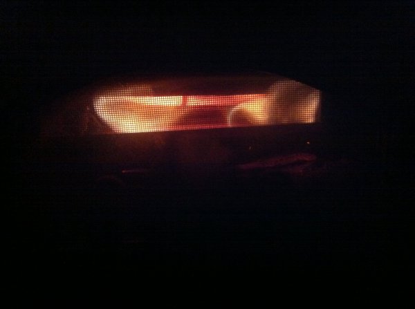

    It happens.

    Everthing ok?

    Yeah, it's no problem. Didn't see it with the expanded-metal cat screen, but with the newer mesh screen I got that in the Keystone and Fireview. The smoke and gasses are igniting before the cat due to the high temps there. Fox, not for sure but don't you have a ceramic in there?

    Woody Stover, Its a SS cat.
    wildwest, yeah its fine. Just thought I'd post a pic for the people that haven't seen it. I should have done a video...

    I got that going on right now. It kind a bugs me but Woodstock says it's nothing to worry about.
