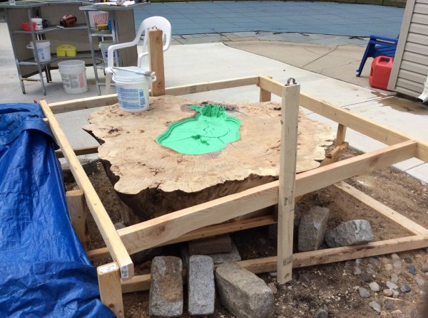

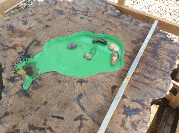

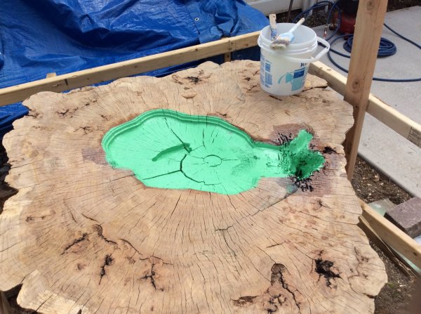

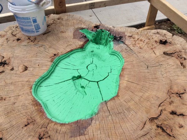

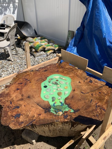

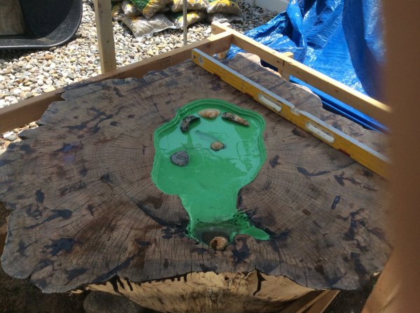

    Got all my epoxy, just waiting on some purple metallic metallic color. I started last weekend and did a little more this past weekend. It’s a staged process for me. Weather has to be between 65-85 degree. I sealed the bottom of the cut out, added 2 coats of paint & primer, then another coat of epoxy, I’m filling up that hole an inch at a time.
    Planning to get more done this weekend.
    Brad, check out a You Tuber called Bens Worx, he did a sweet Lazy Susan with hand tools epoxied in the middle

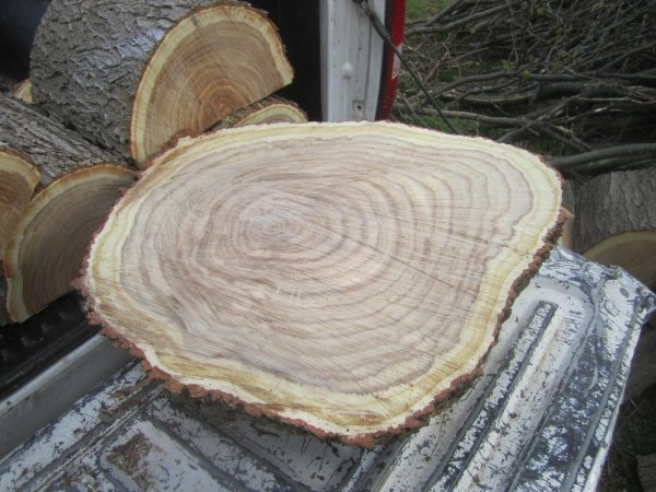

    I understand, waiting on the weather. Thats gonna be quite a table when youre done. This the slab i gave him. I may have to slice a cookie off of it for him. He originally wanted an oak cookie for a wedding gift. He was making a lazy Susan. IMG_2576.JPG

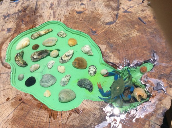

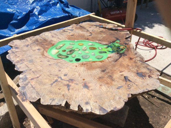

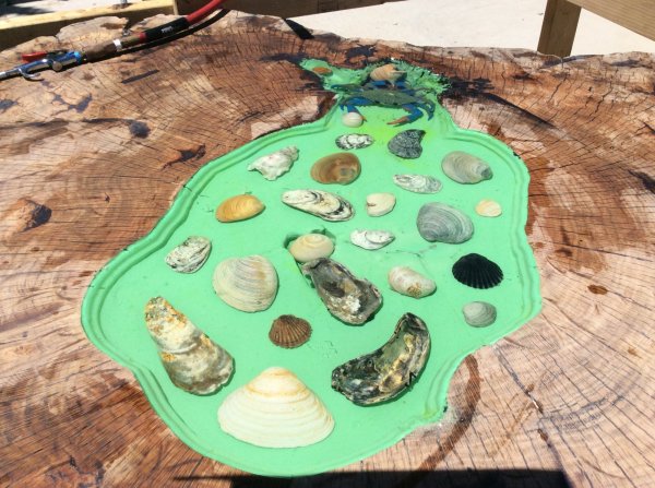

    Got my shells and crab covered in epoxy, next week is the coating of the entire top surface, about 4 coats of epoxy finish.

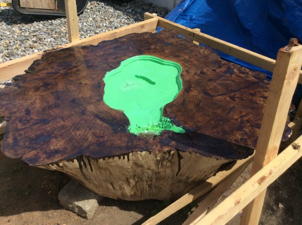

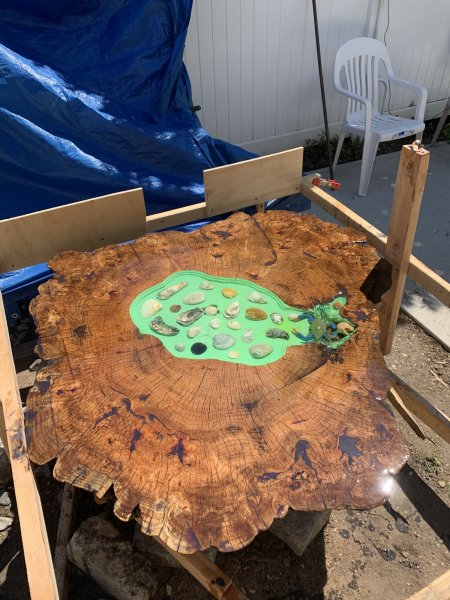

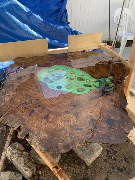

    Applied the 3rd epoxy coat on today. It’s tough to see in the picks but the cracks and checks on the top were filled in with epoxy mixed in with purple metallic powder. It’s really starting to shine though now.
    Next week will be the final top coat.
    Then at a later date I will sand down the sides and decide if I’ll finish them with Tung Oil or left over epoxy.

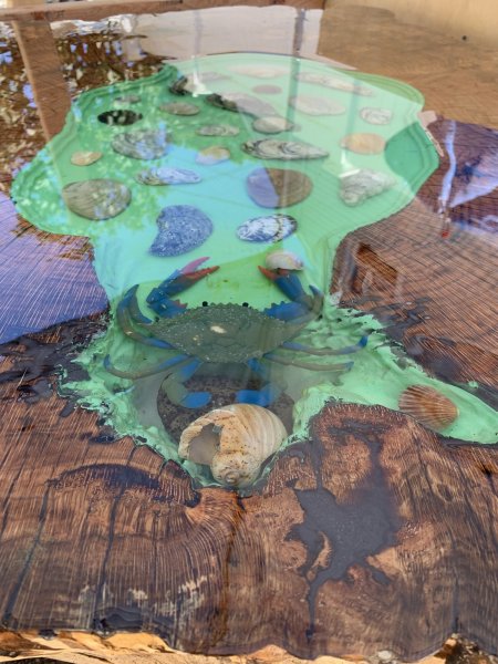

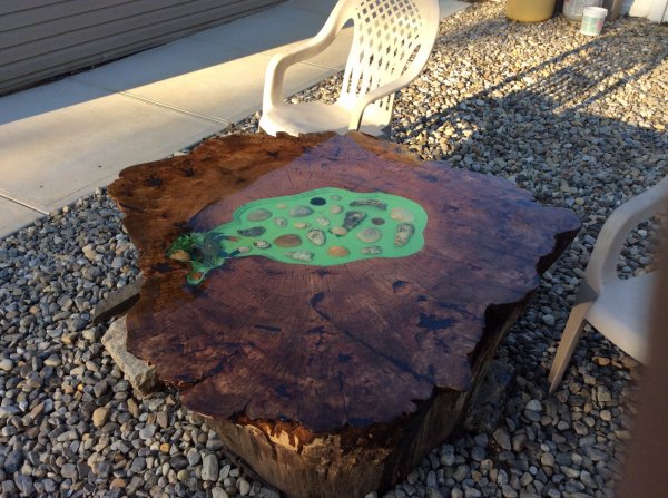

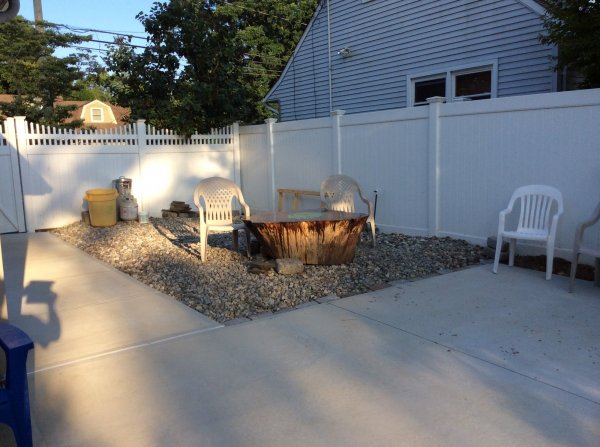

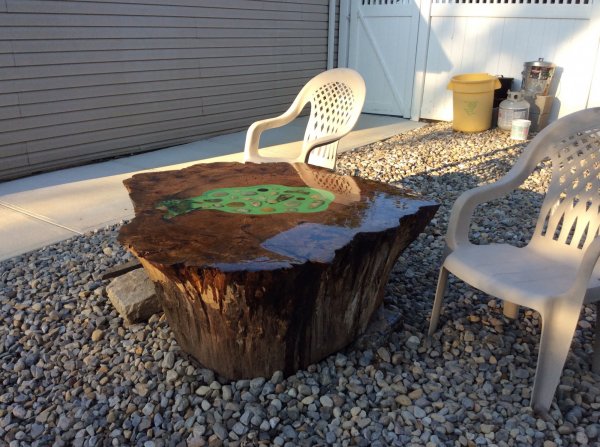

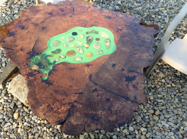

    Finished with the last layer of epoxy this past Friday, finished laying the pond pebbles as well. Will finish the side of the stump at a later date. Really pleased with the end result. Waiting on some more patio furniture to dress the area up a bit and I’ll be good for the summer.
