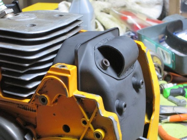

    I installed a new Caber ring and got rid of the base gasket. Modified the Muff and cleaned up the ports alittle. Advanced the timing by a couple of degrees and got rid of the decompression valve. I also added some finger ports. Nothing serious just mild modifications.

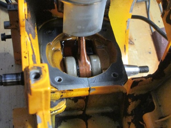

    In the first pic you will see the crankcase filled with 2 cycle mix. This was a tip from Cut4Fun on how to check the crank seals. I let it sit for about 4 hours full of mix and would move the crank to a different location every so often to see if there was any leaks from the crank seals.

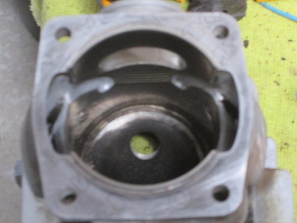

    No leaks and all was dry around the seals. So that is a pass.
    Here is a pic of the finger ports.
    Muffler mod.

    The mix in the case .... after draining and putting the top end on, do you do a P/V test for the entire assembly?
    Mag Craft likes this.

    No I never did a pressure or vacuum test after putting it together. My main concern was the crank seals because everything else I replaced was new.
