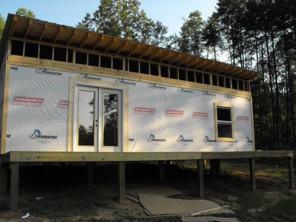

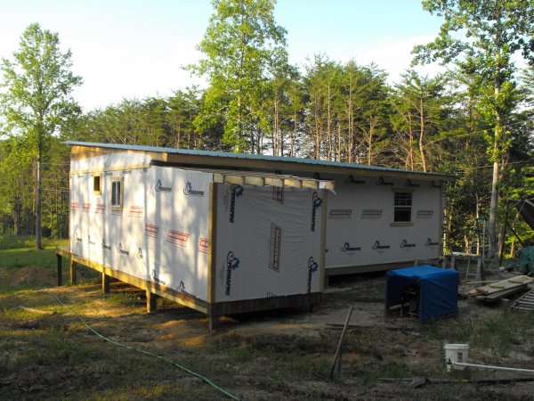

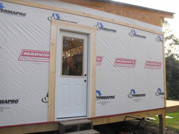

    Getting close...added an 8' X 8' utility room on the back to eliminate putting the washer/dryer/water heater inside (gained 10% more floor space)...got 2 of the 3 doors on and all three windows in...finished trim, and will be starting on siding next couple days...wife is finalizing interior layout (not too many ways with only 640sf!) and narrowing down paint colors. DSCF1004 (1).JPG DSCF1005 (1).JPG DSCF1008 (1).JPG DSCF1007 (1).JPG DSCF1006 (1).JPG

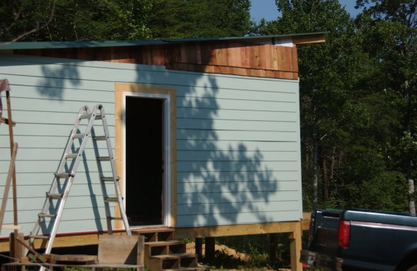

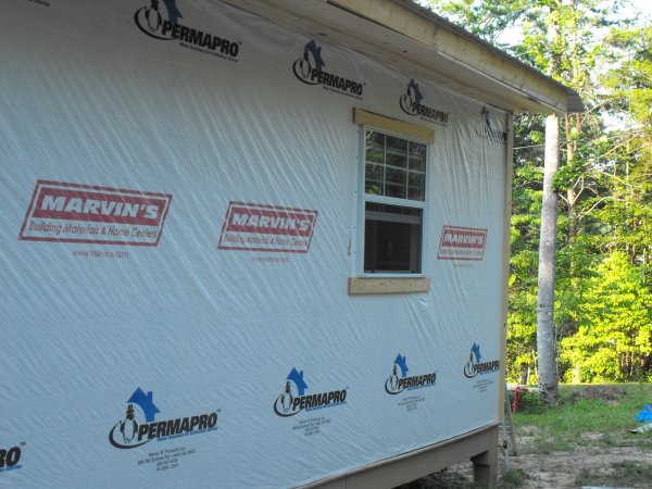

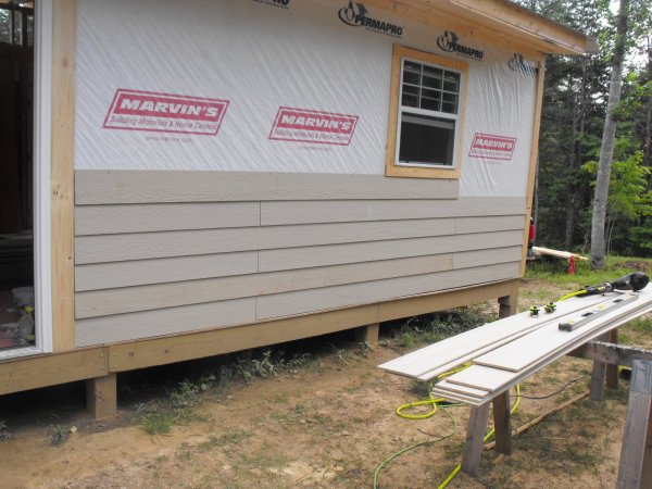

    Started the siding today! We went with the engineered wood siding..about $7 per 12ft piece...got 103 to start, figured around 140 initially, so we will see how far we get, then get the balance. Anyone that is considering re-siding, you need to invest in the holder tool...I got the "Solo-Sider" brand and can't imagine doing it without them. Fully adjustable (reveal) and if you are not so square you can slowly adjust one side or the other to hide the mistake over 5 or 6 courses and you don't notice it. About $60 per set, but well worth it. Also put the door hardware on 2 of the 3 doors. First pic shows the tools on the siding on the saw horses. DSCF1001 (2).JPG DSCF1002 (2).JPG

    Looks good but I'm sure you know that painting the window trim after the siding is up means a lot more work masking it.

    That is going to look great. Do you caulk at the butts or is there some overlap thingy so water can't get in?

    The window trim will be stained and sealed...paint, of course, will be latex and then stain for all trim. At least that's the plan..till the boss changes her mind!

    All gaps will be caulked prior to painting...and there is housewrap behind that now to stop any water infiltration in the meantime. I tend to over-think everything!

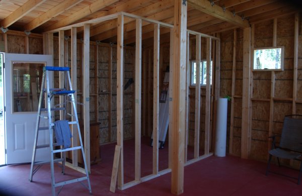

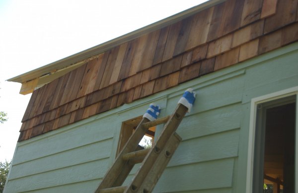

    Been back at it...got all the siding up and painted. Started on the cedar shake for the top of the sides...will be on both sides and along the very top of the front...wanted something to break up the look of siding. Next is the top of the front with plywood and non-opening windows for extra light..and then trim out with the cedar. Also my wife built and put up the walls for the bathroom...I'm pretty proud of her! DSC_0001 (2).JPG DSC_0003 (2).JPG DSC_0002 (2).JPG DSC_0004 (2).JPG

    Wife did a nice job framing :thumbs::yes:
