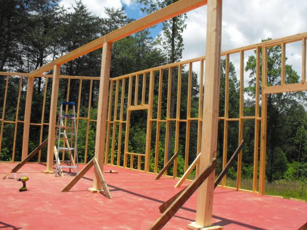

    Moving along...got all 4 walls up and am now prepping to set the posts and beams. Laminated 3 boards @ 2" X 6" X 96 to make roughly 4.5" X 6" X 96" and will have 4 of those to equal the 32' span. Thought about 2 @ 16', but they would be kinda heavy and will be set at about 9' high...also have to incorporate the angle (approx 8.5 deg) at the top of the post. Other pic is of Desoto Falls...just over the Alabama border, about 15 minutes away. DSCF1003.JPG DSCF1007 (2).JPG

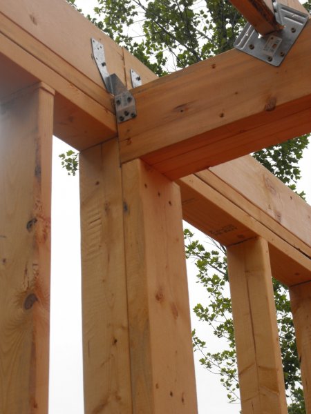

    Got the posts and ridge pole up, and working on joist holders/hurricane straps (100)...next up will be roof joists (2" X 6")....getting close to buttoning this up! Will get more pics today, and will get some that shows more up close details. DSCF1001 (1).JPG DSCF1003 (1).JPG

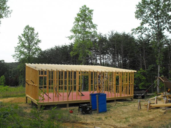

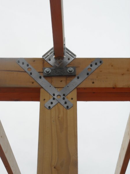

    Soooo...back on the land and ready for the next batch of pics...first one shows roof joists up...next two are details of the ridge pole and bracing (consists of 4 beams @ 8' each and wanted to make sure they are bolted and strapped together) and last one is the opening for our (double) front door. The wife is slowly cutting the front "lawn" and I will be taking some of that and putting in raised garden beds. Monday we start putting the boards on for the roof, then tar paper, and finally the metal. DSCF1001 (2).JPG DSCF1004 (1).JPG DSCF1003 (2).JPG DSCF1008.JPG DSCF1009.JPG

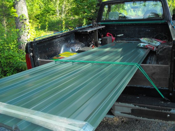

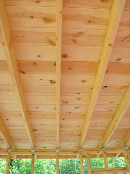

    Update...got the roof boards on...1400+ lnft of 8" wide tongue and groove pine (my hands and knees are killing me!) instead of OSB sheets...cost 3X as much, but the wife wanted it and it turned she was right (where have I heard that before?), it looks great...tar paper is on and metal roof going on Thursday...really looking like a cabin now! DSCF1005 (1).JPG DSCF1006 (1).JPG DSCF1002 (3).JPG DSCF1001 (3).JPG

    I would have used OSB for the roof and then the pine for the ceiling on the inside so you could enjoy it all the time. A layer of insulation between the OSB and the pine (outside and inside) would have helped also.
    Do you intend to insulate the roof/ceiling? Maybe you won't need it down there?

    I don't intend to insulate...thus the better look of the pine. I bought an 80's era Ashley wood stove, and with only 640 sf I think it will blow us out, but will know in the fall and winter if we have to do something. Maybe something removable...we'll see.
