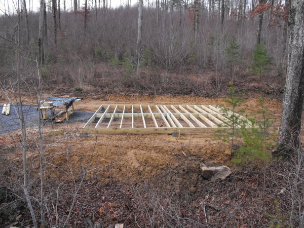

    Went up and was able to get quite a bit done...the base framing for the shed. Am going back first of the week to install sub-floor and then walls. Have the trailer "livable", so at least I can stay overnight, as it is 150 miles round trip! Shed is 20' X 20' and I need to get it done by month end so I can empty my storage unit and save $110/month. More to come! DSCF1021.JPG DSCF1022.JPG

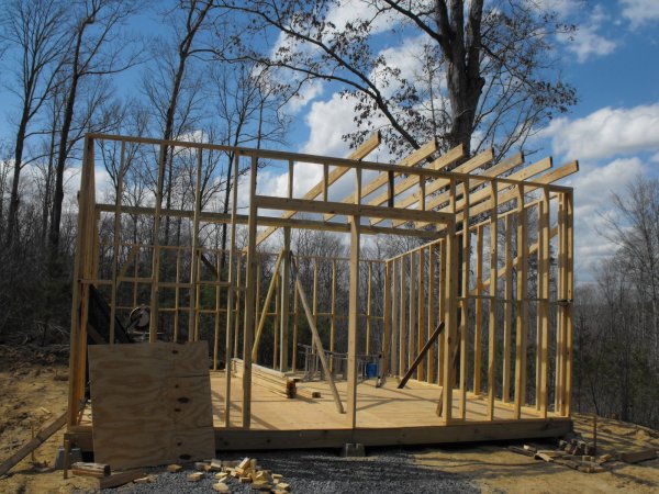

    Been busy the last few days...it's really coming together on the shed. Once I finish it I can start on the cabin. DSCF1027.JPG DSCF1030.JPG DSCF1032.JPG DSCF1031.JPG

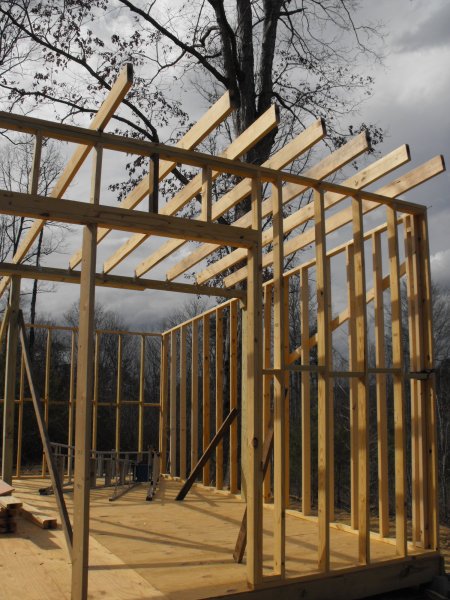

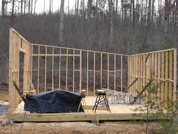

    More pics! Got the walls finished..and my wife came up and we started on the roof rafters. Almost done with the shed! DSCF1033.JPG DSCF1034.JPG DSCF1035.JPG

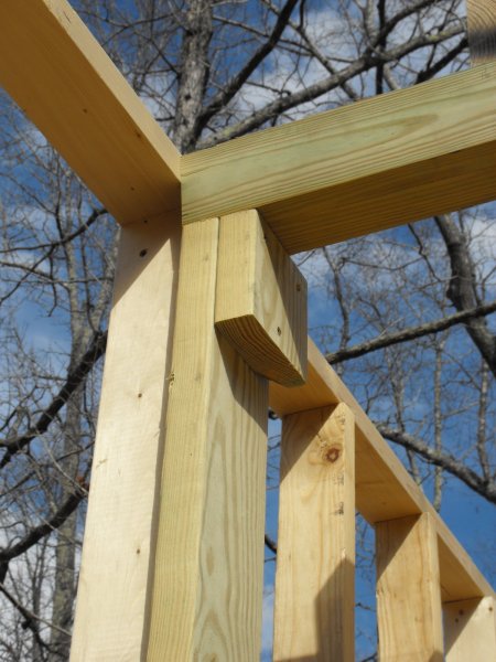

  12. yooperdave
    35,846
    225,454
    It is nice to see the progress, but.....
    Without offending you, I hope the building doesn't settle. The only supports are those pre-formed storage shed concrete things.....
    I hope the roof doesn't sag. Can't really see what you're using for support across the center of the building. 4X4 or 6X6 (above what looks like a 2X6 laid flat?)??
    Hard to tell from pics.
    It would be a shame for either of those to happen over the years.
    Hope you meet your time frame for the storage rental deadline, good luck!

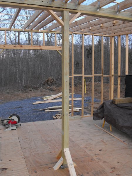

  13. JC@ATL
    JC@ATL
    Jul 2, 2014
    346
    1,190
    North of the ATL
    No offense taken...The land is on a mountain, so the ground is pretty firm. The "ridge" pole is actually 2 @ 4" X 4" at 10' to run the 20' width..I have since added braces at the vertical junction with the 4" X 4" post. The supports at the walls are 2" X 6" attached to the double 2" X 4" wall studs, and I added another shoulder piece for good measure. Down here in Georgia we don't have to worry about snow load. Finally finished the roof joists and purlins for the metal roof, and should be able to finish up next week. DSCF1037.JPG DSCF1044.JPG DSCF1043.JPG

  15. Kimberly
    Kimberly
    Mar 19, 2015
    5,072
    12,819
    The Kangaroo State
    I would not want that center support in the way of the opening. I would consider a beam to take the load over to either side with proper support at the side walls. Or two posts on either side. Even if the only equipment is going to be a ride-on mower you will end up cursing that post being in the way of the opening.
  16. Oldman47
    Oldman47
    Feb 15, 2015
    1,798
    6,501
    Illinois
    I see lots of bracing in the earlier pictures but in that last set it looks like you have removed most of it. Don't forget that it is very unstable until you either place rigid siding on it or establish diagonal bracing on the walls.
  17. JC@ATL
    JC@ATL
    Jul 2, 2014
    346
    1,190
    North of the ATL
    Agree...if a 20' beam was in the budget! The post is in the middle of the 20' X 20' space, so it still gives me 10' coming in before it gets in the way.
  18. JC@ATL
    JC@ATL
    Jul 2, 2014
    346
    1,190
    North of the ATL
    I am working by myself, so I over did it on the bracing while raising the walls. Got all the siding up, as well as the roof panels, and you are right about bracing...everything is pretty well locked in right now. Am thinking about going back and adding some full width ones soon, since I am not going to put up paneling.
  19. Oldman47
    Oldman47
    Feb 15, 2015
    1,798
    6,501
    Illinois
    A single 1x4 stretching across each wall would be plenty to keep the wall from racking. Long before they started using plywood or OSB on walls they used to be braced with a 10 foot long 1x6 set into the studs at each corner to form a 3,4,5 triangle. Next generation was using a single sheet of plywood at each corner and these days most have a full covering of a bit thinner OSB. I used 7/16 nominal.
