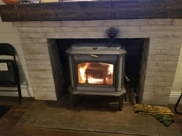

    If it hasn't been mentioned, get the "ash lip" since you are so close to the wood floor in front. It doesn't catch ashes but it deflects the radiant from the glass.

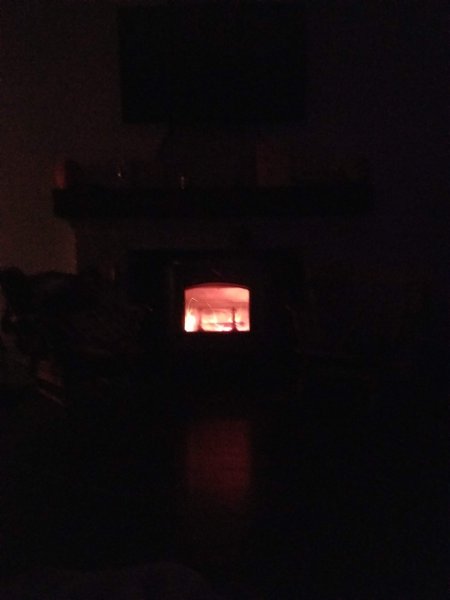

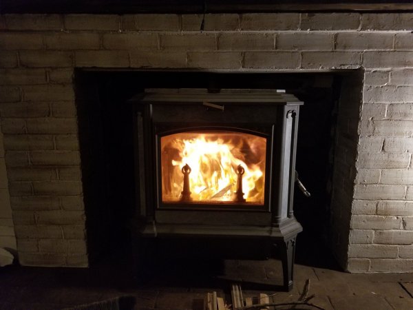

    FINALLY INSTALLED!!!!
    Finally got the stove pipe installed. Ended up using Class A stove pipe all of the way to the top after talking to a local wood stove installer. Our house was built in 1890 so the chimney didn't have ANY liner at all, so the flex pipe we were going to use wouldn't have had the required clearances to combustibles. I feel like it maybe would have worked but decided to be safe, rather then sorry. Had to move the stove back a little father then I was expecting, but I can still load wood and have access to the ash pan, and I can still open the top enough to get to the cat. If it ends up being a problem, I will just have to rear-vent, but we are going to try it for the winter and see how things go.
    So far, heat hasn't kicked on since I got it going, 28 degrees outside and its a easy 65 in the house. Definitely going to need a blocking plate. Going to install that sometime this week. Didn't really even know about them until a few days ago, and just didn't have time or the energy tonight to get it done.
    So far, getting great secondary burns. I am SO excited to finally have this thing rolling!
    Pictures are from me starting it up. No secondary burns in the photos

    Looks great paintblljnkie! I really like the pic with the room dark. Very cool!
