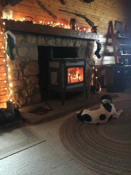

    My stove is situated so the door will open 90 degrees and give me room to load. The top of the stove can open for maintenance and the lid will rest against the stone if I don’t want to remove it completely. The ash pan has plenty of room to be removed. I do have a small fan situated behind the stove to circulate air. My configuration didn’t allow for the top exit pipe. I have the rear exit going into a T then connected to the lined chimney. I did add the ash lip option, it’s a simple bolt on option that can be removed if I move the stove to a different location. The ash lip reduced my clearance requirements for the front. Obviously the dog still approves.

    Wow, that is a really nice installation. My plan is to put some type of stone behind the stove and I would like a mantel; I figured if it is made from fireproof materials I can have a mantel even with my stove pipe and I could go double wall pipe at some time.
