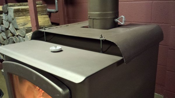

    Yeah, I made a convection deck for it. It really should come with one. This forces the air over the stove top. The stock deflector on the back doesn't do much at all. IMO.
    Now all the air comes across the stove top.
    The stove top was probably about 750°-800° the flue probe was around 1,000°, but it drops off after the initial start up. Normally settles in about 600°-700° and the stove top a little hotter than that.

    Yea I see that type of deflector on more then one brand of stove and I questioned how effective it would be.
    Looks like yours would be a good improvement.
    DexterDay likes this.
