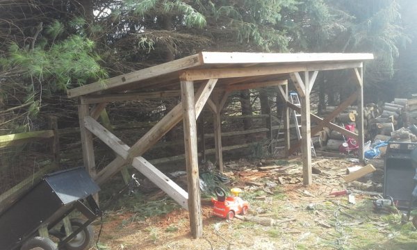

    Mine looks kinda rustic. PHOTO_20140408_165343.jpg this was right after I built it. It's full now:D only spent about $60 or less on it. All old cross arms from work for frame work. $20 for the unused roof that was in my BIL's barn and $23 for some new screws.
