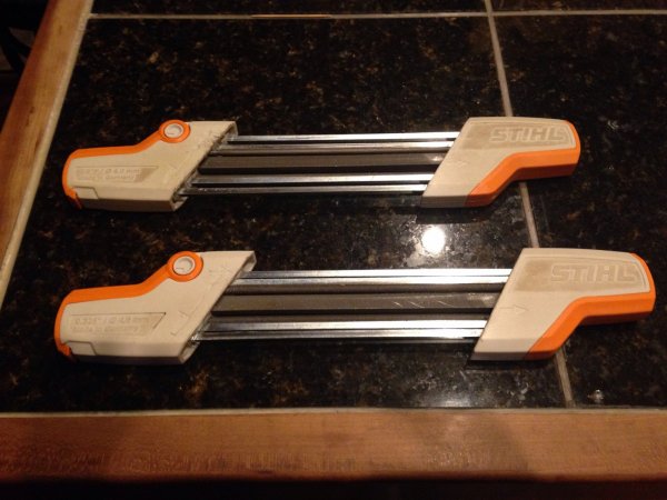

    They are awesome and worth every penny. I can sharpen a knife a surgeon would be proud to use, a chain though is another story. Best purchase I've made since the Polar trailer and the pickaroon. Had a friend that used to do them with an electric sharpener but I felt it took too much of it each time. Maintained regularly, the Stihl sharpener with 3-4 smooth strokes per and its hot knife through butter time...

    I have to agree. Before I got one I think I made my chains worse by attempting to file them. Now in a matter of minutes they are pretty respectable. best money I have spent.

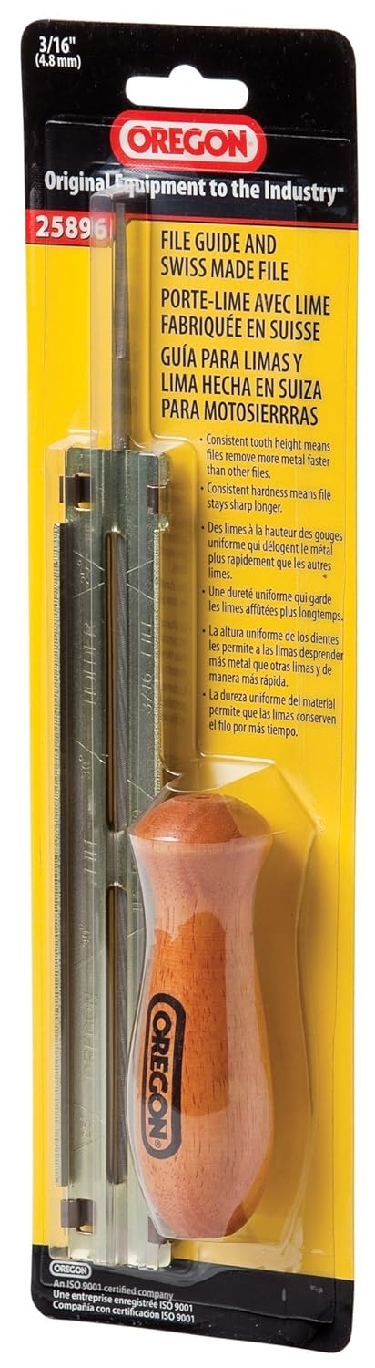

    I don't do much cutting anymore, but when I do cut, I use a simple file guide. Cuts are really good. Only takes a few minutes to trim up a chain.

    Got a link for that sharpener? I so hate having to ask friends to sharpen...I did it a few times but results were less than perfect....o_O

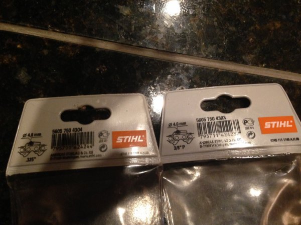

    I don't know about being all technical soft/hard-dirty, etc-these keep it even, takes the rake down and makes my chains last a long time-they were not $40. each...thinking @ 30ish...files of course are replaceable, angle is easy to maintain on Stihl chains-worth every penny to me... image.jpeg image.jpeg
