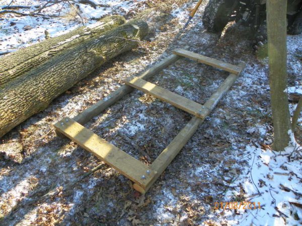

    For hauling logs, here is a dray I put together for about $10. This works very well in frozen or unfrozen ground and with or without snow. Back in the day when I worked in the woods, we used something like this (naturally on a larger scale) for skidding all the logs. If built right (hard to go wrong though) they pull almost as easy as a wheeled outfit. And yes, we've pulled loads through mud.

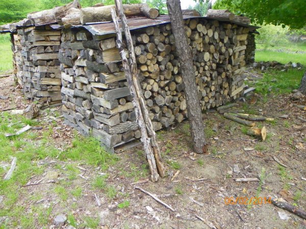

    Yes on the arched roof. We do this and sometimes some of our wood piles will look more level but they will be higher on one end than the other so that rain flows off.

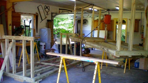

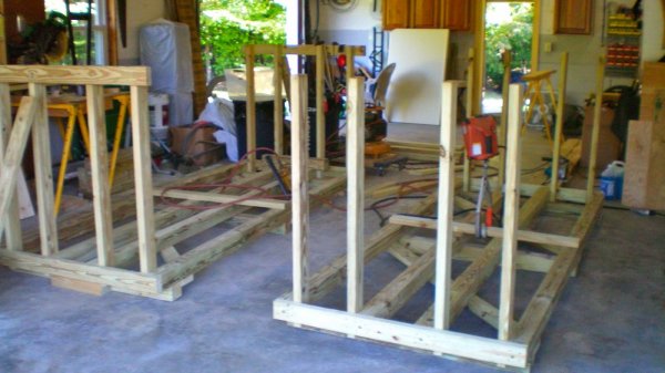

    I liked the double row set-up you use because of stability. Dennis' racks all were sloped, and that just made sense, as I was gonna pull tight to both ends with the tarp. I also pulled both ends to each other in the middle, with some 3/32" old aircraft cable I had... to help with the outward load. I may use Augie's idea later, and wrap them to the ground for solar drying. It would make them less likely to end up being a yellow jacket shelter too. Here's a shop pic or two of em.

    Nice looking wood cribs, buddy!!
