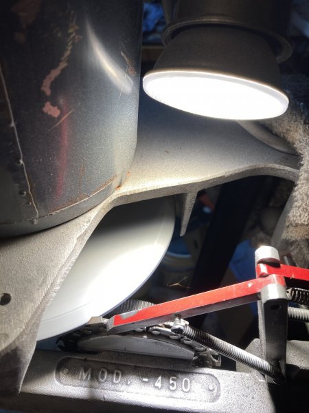

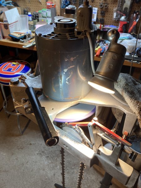

    Agree'd. This and the fact that I have arthritis-like symptoms after vigorous use of fingers/hands, both of which led me to seek out a grinder. I should have got one long ago! No regerts. Lol.

    That things a monster! I've seen one at a saw shop once but don't know anything about them. Very impressive!

    that is a grinder for chisel profile, common name square grinder, unless you re-profile the wheel it does not do round style teeth - not sure if even re-profiling the wheel would accomplish that or not. On the other hand the common shop saw style grinders are not any good for a proper chisel profile. Drawback is you have to go back at some point and clean out the gullets as a second operation when using a sq grinder, and of course still the depth gauges to adj.

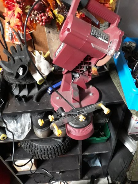

    I have always Sharpened by hand, but i had a 20% off for harbor freight, and a couple chains were cutting curves (GOOD CUTS, BUT CURVES), so I figured I would try their sharpener on the MS 290.
    Stay tuned...

    I use this little piece of crap and once I learned it I can sharpen 3 chains more accurately than by hand. Still love bybhand tho. It really connects you with your saw. U know what I mean?
