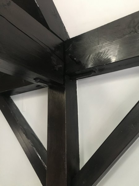

    Woodwhore you have a beautiful home, love the beams, I like wood beams in a house, I might have 1 or 2:whistle:. I have never liked the painted wood look but your might make me change my mind.

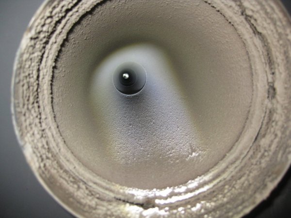

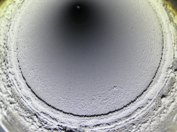

    Here's after a WHOLE winter of burning for me.

    Welcome JRHAWK9 nice to meet ya. That's some clean burning right there:tip:

    Welcome JRHAWK9 - You're gonna like it here, I guarantee it. That's a slick looking flue. Lots of good people here and glad you've come on board. Nice to meet ya. :handshake:

    Thank you very much, I get a good draft too. Ill have to further investigate the insulated pipe. 0FB97CCE-15C6-4729-B778-CD8582EC3EA8.jpeg The beams are actually ebony stain with clearcoat. I let her paint the beams white in our bedroom and thats it, i like the wood too and you can still see the grain. The pic doesnt do it justice.
