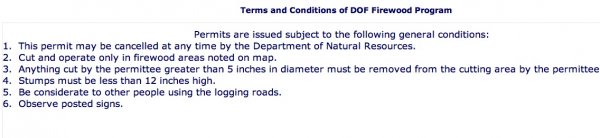

    I have these rules to follow: ( 12" or less stump)

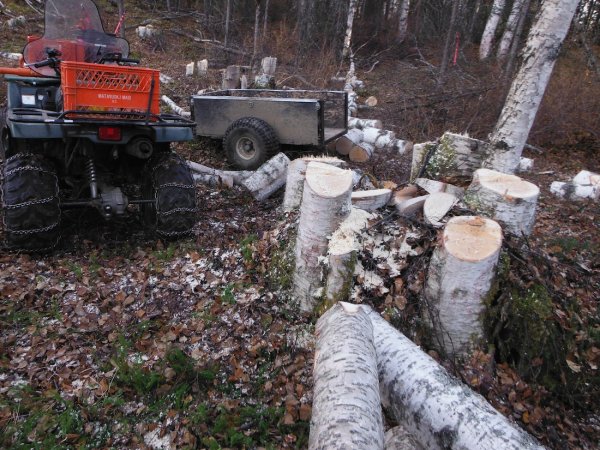

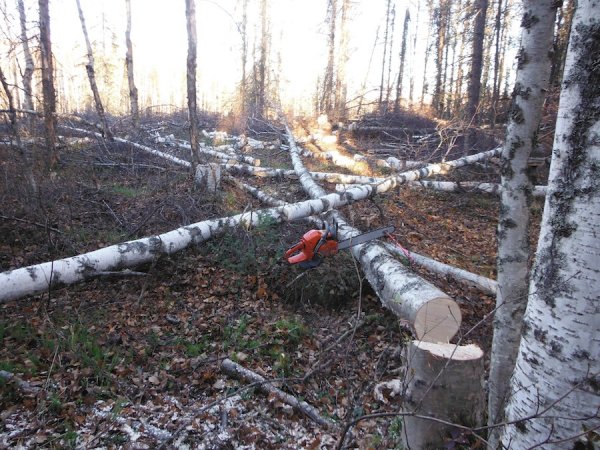

  7. bogydave
    The trees at the cutting area are not huge
    Typically 8 - 10 trees to get a cord
    One load this year was 15 trees,
    one nice thing in this area is it's thick woods,
    trees have no/few limbs till you get to the crown, less liming
    Previous area had older, bigger trees,
    I got a couple loads there with 6 trees
    some were 18" (wow )
    but much of it was rotten centers
    some from this years cutting
