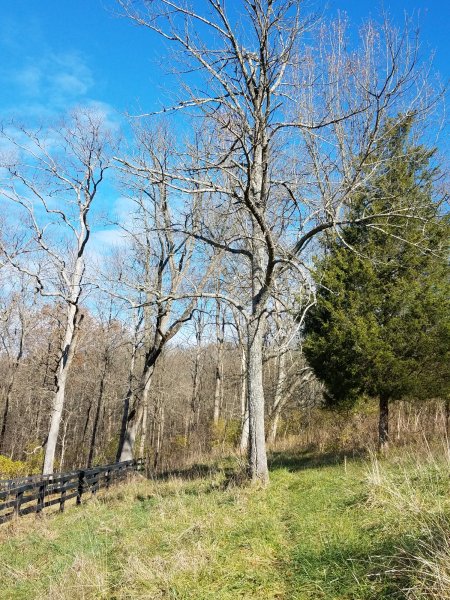

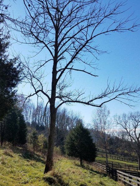

    Dead ash next to the horse farm fence. I don't know if you can tell how much downhill the land is. Sure don't want to bust up the fence, even it equals job security!
    I want it to fall parallel to the fence so I'm thinking to notch it aboht 70° up hill, plunge cut it, drive a wedge in on the fence side pointing up hill then cut the strap. Think it will work?

    I'd absolutely use a winch or come along to tension the tree to fall uphill.

    The lean is hard to judge in a picture. When I use a winch to pull one down I leave a thick hinge

    We all know its obviously safest to fell a tree down hill. But someone built a darn fence there!:rofl: :lol: Up hill would be second safest. Parallel with the hill can be very dangerous because of log roll.
    Having felled a "few" trees in the hills of Oregon, this is something I see trip people up sometimes. The grade or angle of the terrain has little impact on the actual lean of the tree itself. To me, in the pics the lean appears to be minimal. The terrain just fools your perception.
    Holding any improvised plumb bob (ex. A straight stick, like the twigs Eric VW uses to walk on:rofl: :lol:) from your outstretched arm and hand will give you a good judge of the lean even on broken uneven terrain.
    Like walt said it's always hard to judge lean from 2d pictures. If the lean is the same in person as it looks in the pics, your plan sounds good to me Ralph. Except that if you want the tree to land parallel to the fence I'd move the notch closer to perpendicular with the fence.
    walt called it again on the hinge I'd leave it fat and use the fence side wedge to finish the fall. I'd also make your notch open faced so the hinge stays intact until the tree is on the ground so as to minimize the danger of the tree rolling. Having the tree point slightly up hill will minimize the danger of the tree rolling as well.
    That is how I would do it based on what I see in the pictures. But what matters is what you are comfortable with Ralph. If your uncomfortable with the fall, it couldn't hurt to toss a rope into the tree to help pull it where you want it. That'd be cheap insurance in my book. As always be safe brother Ralph.

    After the company departs I'm going to spend some 'quality time' re-evaluating that tree. I'd rather drop it up hill but, at first look, I thought the slope and lean were a bit much.
    I'll take the plum bob and check out the lean and make a determination then. I also figured on removing the lowest limbs with the pole saw before I drop it. Because most of what is on a hill I usually use an open face notch or a bore cut.
