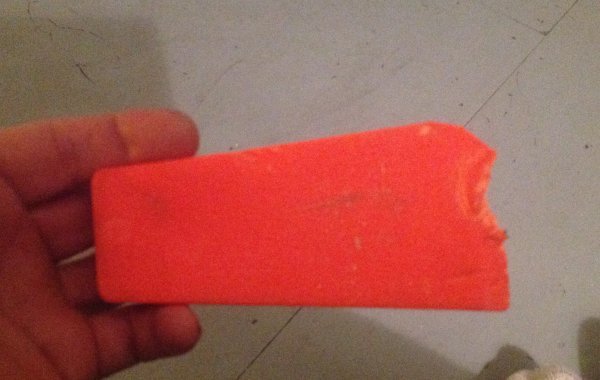

  4. Kimberly
    Kimberly
    Mar 19, 2015
    5,072
    12,819
    The Kangaroo State
    Here is the one that I made this morning.

  6. Dsltech
    Dsltech
    Mar 1, 2017
    32
    161
    Rensselear ny
    Looks good! I wouldn't expect it to last as long as a plastic one but it looks like it will work just fine

  7. Kimberly
    Kimberly
    Mar 19, 2015
    5,072
    12,819
    The Kangaroo State
    I took one of the logs bucked out of the dead hickory and using my splitter I split out a plank. Then I squared it up. I marked guide lines and then cut kerfs that I removed with the chisel. Then I dressed it up using the cheap belt sander I purchased at Harbor Freight as my gift since Father Christmas forgot to stop by my house.
    Of course someone with the proper wood working tools could do a nice job. I do have a table saw but it has not been set up; it was one of Lowe's Black Friday deals a few years ago. Trying to get the shed cleaned up.
