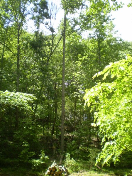

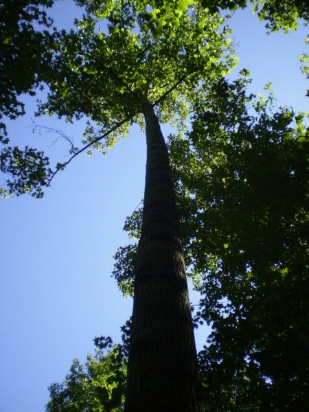

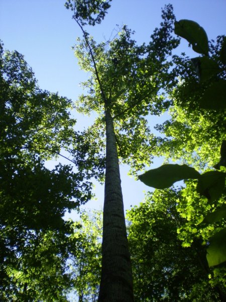

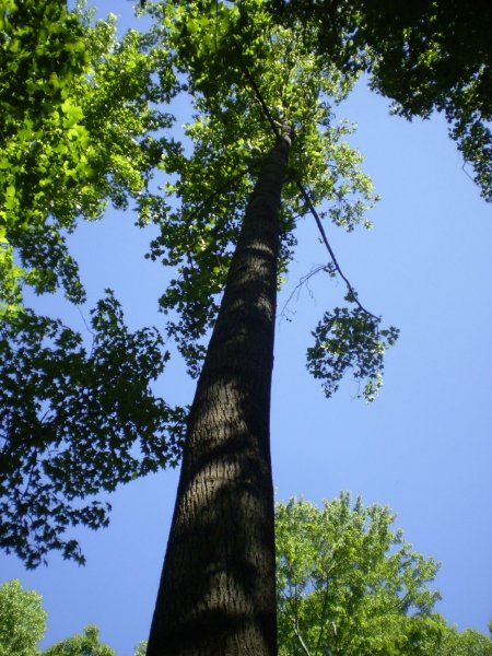

    With the hickory now out of the way, I can think again about dropping this poplar. I know it is not easy to see things when you are not standing under the tree but thought maybe some photos might give an idea. The photos below were taken 90 degree apart around the tree.

    Big enough to cut the wedge
    Plug cut the back cut to a good hinge & leave
    a few inches to hold the tree
    Then finish the back cut ?

    Get a rope up as high as you can (20' plus?), cut the notch, put some tension on it with the 8N in the direction you want it to fall, then make the back cut. Those few twists and turns in that trunk are so spread out....that tree will go where you tell it to go. Getting over the drum beating in your chest is the hardest part! :thumbs:
